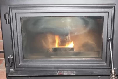

I am working on my second ton of pellets now. First patch were Lignetics. The next wo tons are Presto-log by Lignetics. Here is the issue I am having. After a thorough cleaning the stove runs fine and produces plenty of heatm however the glass gets a black soot on it, as does every internal part of the fire area.
I have read numerous postings about the factory settings ( the three buttons at the bottom of the control panel ).
LFF (lower fuel feed), LBA (low burn air), AOT (Air on temp) with settings of 1/4/1. The factory states the codes should read 6/4/1. I adjusted the LFF and refired the stove and now have the black soot right away on the glass.

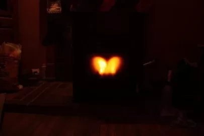

The image looks like a set of buttcheeks. Meaning the black part is near the top with two nice round spots in the middle and to the sides.
What can be done to eliminate this soot issue. The stove is only 6 weeks old and everything, I mean everything is very cleaned out. Exhaust, intake, burnpot, airwash (which is a joke) both blowers. Attached is an image trying to show what is happening. The stove has been on 30 minutes.

If you just "cleaned" it and it started happening, you might ash stuck somewhere.....might be an airflow issue....BTW, your default setting are 1-4-1 not 6-4-1...which will also cause your problem...too much fuel....

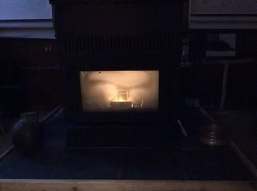

This is what my PAH looks like after 8 hrs, burning PennWoods . My favorite pellet!! Bar none

Here is what I have now buring Lignetics, I picked up Pennwoods and Wood pellet co. bags today. No more butt shape, more heart shaped.

this one aint getting any air, I suspect its needing a plates off cleaning, look behind the ash drawer for the two plates remove the plates vac out, then before you put the plates back on, take a mallet and whack the firewall of the stove above the cleanout openings and see if you have a bunch of soot fall down from above, if so keep whacking until the crap quits falling , vac it out again and reassemble

don't set to 3-3-1, would make it worse from what I see in the picture, stove seems to be wanting for air , that adjustment will make it run richer better to raise the LBA up a notch , also check to ensure the burn pot is seating down flat and the ash drawer is seated tight at the bottom. and if possible take a clearer picture the one you shot is quite fuzzy, maybe also a shot with the door open so I can see what it looks like in there (between fires not while burning)
