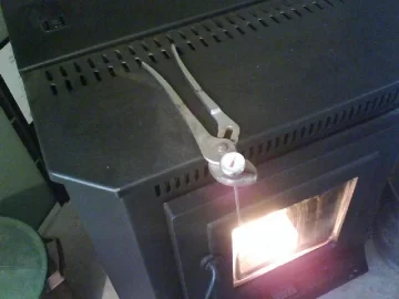

I want to squeeze as much hot air out of the stove as possible. Last year I did some unscientific testing with a thermometer set up a few feet in front of the stove. Increasing the blower did not reduce the temp of the air. I figure the more cf per minute the better. I am not sure if this increases efficiency or not, but I like it.
I have kept a meat thermometer set hanging off a pair of channel locks about 2" in front of the front left room air outlet all season. This has allowed me to see exactly how the different settings and different pellets react. The air is definitely less warm on the higher room air settings. It has to be. More air is moving thru so it dissapates the heat quicker.
Here is a cell phone pic of the thermometer.
ballpark, about what temps. are you seeing?
Yea I really like the thermometer deal, I will have to pick one of those up. I too am interesting in the temps your seeing.
I have done a good clean to expose as much metal as possible for better conduction. I just did it again today and its currently 27F and its 64F in the house. Its ever so slowly coming up to temp. I have the stove on a 3,5 trying to see if moving more air helps.
I have also noticed that the more lights and electric appliances I have on the easy it is to bring the house up to temp which is something I never thought would add that much
currently I have the stove on 3/6. It is hooked up to a thermostat, and the 'stat is currently not calling for heat, so it is in "low burn" setting right now (2-6-1) and pushing 160 degrees. The temperature probe on the thermometer is about 1.5" in front of the front lip. The temperatures are pretty much only useful to myself to know how to tweak the most heat out of it and tune in and compare different brands of pellets. You need to be consistant with where you place the thermometer, because the left side is way hotter than the right. Who knows if my thermometer is even calibrated correctly. When it is more cold outside (10 degrees or so) the stove I set the stove on 4-9, and when the thermostat calls for heat, I get 225-240 degrees. These temps are consistant with both Lignetics and Barefoot. When I burned my 1/2 ton of Northern Lights Softwood, I barely got 180 on 9/9. Pellet brands make a huge difference.
