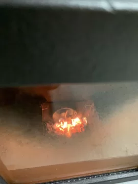

Hi all, I’m having issues with a brand new stove. Seems to be the top auger is not feeding fast enough to keep up with the bottom. It slightly moves every 12 seconds or so. The fire about goes out before more pellets get to it. I had the older version and never had this issue. I’ve messed with 2/3 bottom buttons settings to no avail. I was also able to change the blower speed Lower than the heat setting but can’t seem to do it with this one. It blows cold air out and I can hold on to the vent pipe. Pic is much of a fire that happens
  • [Hearth.com] Englander 25-PDVC

I put the 3 lower settings back to factory, 6/4/1. Even if I turn the heat/blower all the way up to 9 it does the same thing just blows cold air out faster. I took the restrictive plate in the hopper out too to see if that made a difference, it did not
