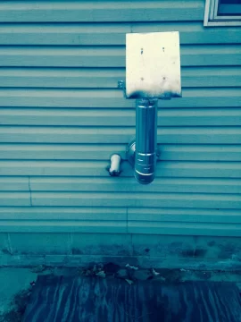

3" pipe 24" from back of stove thru the wall to outside. An elbow and 24" up another elbow then the cap.
1st pic is inside. Phone is being picky I'll try to post the outside pics too
What is the length of your exhaust, how is it routed from the back of the stove to the outside of the house ? < Pictures would help
Is it 3" pipe or 4" pipe ?
These stoves need to have a good draft to burn properly.

Ok, been burning since about 10:45 this morning, so about 8 hrs so far. Just a light white or light gray film on 85% of the glass. A huge improvement from the black soot. I'll see what morning brings. I think getting the outside pipe a bit more was the trick, I am going to try to get another piece to get it a little higher if I can find it, the double wall pipe is really scarce around here.
When I just recently put my venting together I found that Home Depot actually had good prices and ordered everything from their website. If you can fit a few more feet you might find adding a single 3-foot section is cheaper than a couple 1 foot sections($29): http://www.homedepot.com/p/DuraVent...ble-Wall-Chimney-Stove-Pipe-3PVL-36/202269781 if you can add a little more to the order its free shipping ($45 and up).
Mines been running good now since Tuesday with minimal black soot so I'm pretty confident a thorough cleaning fixed mine. Just not sure what caused the plugging, whether its normal accumulation or bad bag of pellets, or combination of things, maybe my venting isn't ideal either.

Wow what a difference. Got up this morning and minimal black soot, the stove is still putting heat out and the burn pot is only half full with ash. Not unburned pellets! I think we r finally getting somewhere. Like ohioburner said if it's still good in a week we'll be tickled to death! Got it shut down now for my morning clean out. Keeping our fingers crossed but will add more height to the outside stovepipe. Thanks so much for all your help.

Outside pic
And the reason why your increasing the height of the vertical section helps is because it stops the stove from sucking oxygen deficient air due to the placement of the stoves exhaust too close to the air intake.
From page 10 of the manual.
F) MIN. 3-FT CLEARANCE FROM A FORCED AIR INTAKE OF ANY APPLIANCE
Was the fresh air inlet ever checked for a blockage, ie...rag, or mouse nest...just sayin'.
