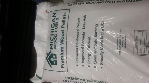

Ohbix. Walmart in massillion had those penningtons. And I went today to lowes in alliance and grabbed 10 bags of these.
