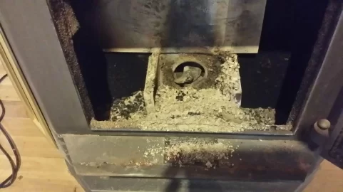

This is 1 bag. 4 hours after shutdown. not nearly as many clinkers but still not what I'm hoping for. [Hearth.com] englander 25pvd troubles [Hearth.com] englander 25pvd troubles [Hearth.com] englander 25pvd troubles [Hearth.com] englander 25pvd troubles [Hearth.com] englander 25pvd troubles
That last photo I stirred the pot to blaze the embers. What do you use to scrape the pot.. a shovel? I don't have a tool to do it and need to know the best thing to use.

Is it just me or does that lower auger look like its sticking out too far?
Also, the impingement plate looks like its too far to the left.

Wow.. I'm am idiot.. the plate must have moved while in transit to the basement and I never fixed it. I'll try that along with the Flue and the Gasket. That plate I bet is acting as A damper and covering some of the exhaust vent. I'll check it out here soon.

Yea, make sure that plate is centered and it wouldnt hurt to make sure to really clean the heck out behind the plate, and burn pot. As well as the blower if you haven't.
