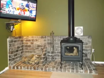

Thanks BB. What is the fan in the picture? Since yours crapped out, what have you used?
One he bought off of eBay. I have the stove half in and half out of the fireplace so I have a fan in the lower left corner blowing into the fireplace and it pushes the heat out into the room. I can't pull the piece of crap AC-30 off the stove because it is too close to the back of the fireplace and I don't want to pull the stove.
I use this set up with mine on low. I either put it there or on a little table near the stove and leave it on low to keep air circulating. Just a cheap little fan that I have since upgraded to a black model. The fan that came with the stove is too loud and only still on the stove for the off chance of an overfire situation and will probably get transferred to a forge I am building at some point.

Not sure exactly how your blower attaches, but I have one of these behind/under my PE stove, pointed straight up. It blows up behind the heat shield and across the top, and does a remarkably good job. It was a temporary thing, but it has become less temporary since it works so well.
http://www.amazon.com/Lakewood-HV-9-3-Speed-9-Inch-High-Velocity/dp/B00094CCDK/ref=pd_sxp_f_pt
We use something similar with our NC-30. It's quiet, cheap and makes a big difference in the heat dispersement in the room/house.
