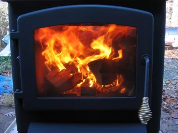

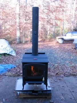

Yeah, cook'er off outside. Stick a few sections of pipe in it and leave the door cracked because draft won't be too great.
  • [Hearth.com] Englander 30 NCH is being delivered tomorrow..
BB, how long should it be outside, a few short fires in one day or longer than that?
Depending on the ease of install, it might be best to send the family out to dinner and heat the stove up in the house with doors and windows open (unless of course it is -10 which i doubt it will be)
