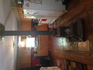

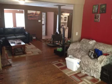

Thanks guys for the info . Woods been split in barn since last winter. I have a vogalzang smaller 4500btu now just not keeping up. Location should work fine accourding to englander specs. I wonder why some units may be 30000 btu differnce but say heat the same amount of area. Here is link too that video.
Also i burn oak mostly . I have aprox 1000 square foot farm house. Its a little drafty . Im currently putting new windows in and insulation. Pretty open floor plan . Wood stove sits on large concrete pad in middle of house with 6" double wall pipe to ceiling than triple wall ,it runs straight up. I was also considering drolet ht2000 or us stoves 2400 others have higher btu drolet is 95000 btu i think and us stove is 115000btu but all say 22 to 2400 square foot heating area. All reviews except the above look good for englander (75000btu) so thats one i was leaning towards.

Lol grizu fire did look pretty smokey and i also noticed the log on top. Thanks every one will definitly be more comfadent buy. Stove i have now is vogalzang model bx26e. It got red hot all winter think house was just way to drafty lots of old window and insulation in some walls had slid down. Thats why i fixed most of that. I just went thru a lot of wood last year about a chord a week. I have 44acres of woods to pock from buy wood cutting isnt neccicarily my favorit past time. Hoping bigger more effecient stove will cut that down a bit.and i will have to get mostior gauge and perhaps relocate the wood .heres pic of most house couple more small rooms of course and pic of current set up.also what do u guys think about heat reclaimers .

Ok, that's not a VZ Defender but one of their cheap non-EPA units. You were wasting a ton of heat up the flue. Plus, it probably pulled in a lot of cold air from the outside to make up for the lost air. With dry wood and a modern stove expect to maybe burn ~4 cords a winter.
The hearth: What is underneath? Concrete does not have the best of r-values. If there is wood underneath the 30NC may not work without further protection. What are the dimensions of the hearth? The shape of the 30NC is very different as is the location of the flue outlet. You may need to extend the hearth at least one side. I would also look in the new Englander Madison stove. It has a 2.4 cu ft firebox which should be plenty for your space and only needs ember protection in the hearth. Here is a thread with lots of info: https://www.hearth.com/talk/threads/madison-in-my-burn-trailer.128150/ It is probably still a special order item. Print out the manual, go to your nearest Englander dealer and ask them if they can get the stove for you. Price should be close to the 30NC.

Tyler - is that 8" black pipe?
Ok thank you. The concreat pad is 6'by 3.5' with some kind of special coating on top it was there when i move in with large old coal burner and had 8" pipe we ran a 6" pipe and kept the 8" around it . Would supply is year old in barn. Going to build storage outside with rood and three sides to let get sun as someone earlier suggested, all oak and hickory but ive not cut any fown just use trees that have been down from storms so were not green by any means when i split . Wish i was up on wood for two years but hopefully since heating small area with large stove it will work. All the advice is great!
Concrete pad is also about 4 inches in depth . Old stove wood get red hot but the concrete wouldnt just. A little warm . Think its cooled a lot from air under the house. The hearth i guess came with old stove. I guess i better find one for the new stove . Cant just sit on the concrete pad even with the pedestal or legs?

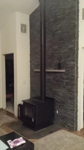

Hi Tyler I realize I'm late to the party here but that video you found is not representative of the performance of the stove. That guy is trying to burn wet wood. I have an Englander NC30 and believe me it produces plenty of heat. My humble opinion, but you can't do better for the price. If you're burning dry wood in it you'll produce tons of heat. I love mine, it's fantastic. Not sure of differences on NC30 vs. NC30NCH

I like your brick work . Makes for a nice thermal absorbtion / release passive system.
