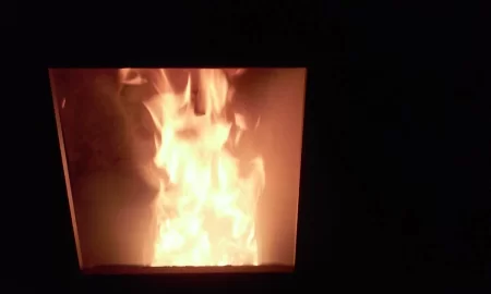

i just did my weekly sunday cleaning. then i remembered this thread and said hey, why not?
so i put some heavy duty high temp foil tape over the holes. It might not last long but i just want it to last a day or so for comparison. I see a difference in the flame, looks more robust. Right now i cant run it on anything but 1 since this is an oddball winter and its actually "warm" outside. will see tonight when temps drop and i can run it on 5 a while.

Well, its pretty cold out now (20's) and my stove has been on all day with the holes plugged. It is running better than i've ever seen. It's blowing hotter, so i have it lowered than i normally would for this temp. There are no unburnt pellets in the burn pot. There is ash in there but there is holes through the ash where the air is coming through. never seen that before. The glass is even clean where by now it would have been ashed over. I think i'm going to pick up those plugs on my way home from work tomorrow. I cant see the foil tape lasting very long in that environment.
