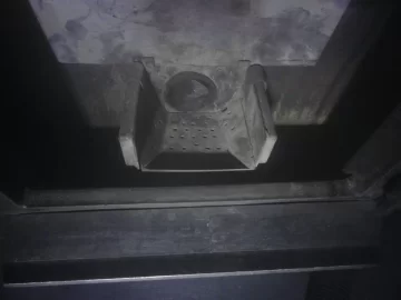

This is what I did to mine. Two metal clips to cover the holes and a new burn plate with sides, it works really well on low and on high.
Looks nice.
Other than blocking the two large air holes, how does the redesigned wear plate improve your burn?
The burn plate works well I tried about 6 different designs this one has bigger holes 3/16 in the center and a few 1/8 hole close to the auger. The slanted sides keep the fire centered so the stove burns at very low settings heat level1 with the lowers at 2 4 1 I do this when its 40 degrees outside with the stock plate the fire would go out. Most time I have the lower setting at 5 4 1. it all depends how much heat I need. The other thing I do is I limit the amount of air entering the stove with a gate valve. I know that I most likely would no longer meet emissions but the exhaust temps with out the valve is 400 degrees plus when on high, by limiting air keep more heat in the stove.
I kind of wish i had the burn pots you guys have to work with. What you guys are esentially doing is incorporating your larger burn plate with the old style burn pot.
There isnt a whole lot i can do to mine without pulling out the grinder with a cutting disc and being creative with the welder... but just in case you are curious now, i do not have those large holes above or below in mine. Just some 3/16" holes across both top sides of the pot and 2- 1/2" or so holes just below the auger. Along with the few holes in the burn plate itself. But not a single hole beneath the actual pile of pellets. Its much harder to explain than it seemed. :rolleyes:
