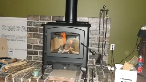

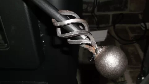

I fabbed up this handle and it adds a little weight with the cast ball on the end that seems to secure the latch very well although I am sure it is unnecessary - I just did not like the gold spring thing
  • [Hearth.com] Englander Stove Door Won't Latch Securely
