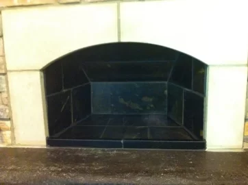

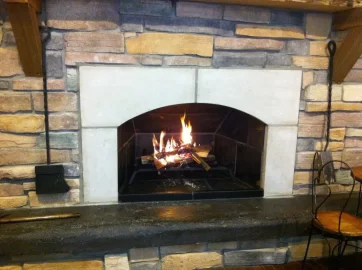

I relined my firebox with soapstone, it really cranks some heat!

webby, nice fireplace! almost too nice to burn wood in;lol. how hard is it to get it clean again after a burn.

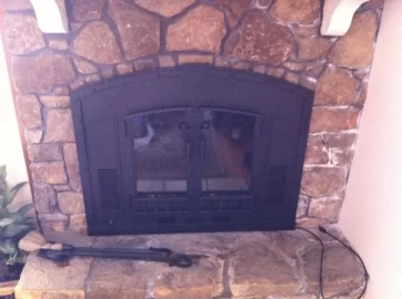

Here is one from Stoll that we did. It actually makes a respectable amount of heat! They are expensive, and aren't as good as an insert. ?

Yeah, that's the Stoll Heat Champion. That's more of a renovation than I'm looking to do.
