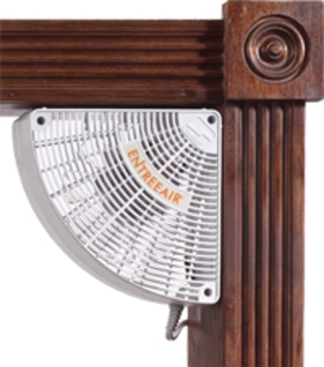

This is what I used in my home. Just had to run the power cord down alongside the doorway trim to the nearest outlet. It worked well...

I've had one of these and did help to a degree, but there is a good 2 feet between where that fan would go and the ceiling. That air is trapped. I was thinking about adding a vent above the doorway, through to the other side if the room. Something like this

You will probably still need some sort of mechanical device to move air thru it.
