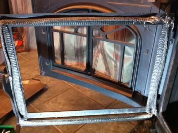

I'm across the street at my neighbors trying to fix his pellet stove. Checked Switches and cleanliness and looks good. Did a smoke check on the door and we're leaking like a SIV! The glass is just about free-floating between the random gasket distributed around the door. The glass is not fastened to the door other than the gasket???? No clips, no screws, no nothing except a corner of the gasket wrapping around the backside of the glass. Here's some pics of the door with the old gasket still there. Notice the lower gasket that never touches the glass... Was this installed correctly? Did Enviro plan on the gasket squeezing the backside of the glass to form a good seal? Thanks. Aaron
![[Hearth.com] Enviro Empress door gasket [Hearth.com] Enviro Empress door gasket](https://www.hearth.com/talk/data/attachments/87/87969-c5125d9aa2e845423d3bc7fe9658350d.jpg?hash=kjfPfpxpWz)
. My neighbor hasn't gotten back to me but I get much more excited about things like this than most folk. Especially when a pellet stove comes back to life! The other design issue I see with this door is the lower bearing that the door latch hooks on to in order to encapsulate the lower portion of the door to the gasket can easily be non-engaged and when you lower the door latch it bends the cheap frame of the door. This was the case with my neighbor, had to bend the door back true. Thanks again for the info. Aaron
