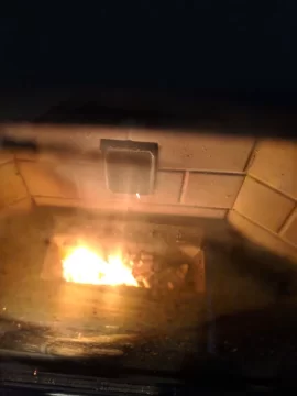

As a note, when the burn pot looks like the picture and I open up the air vent and basically rush air into the burnpot, the pellets on the right still wont catch on fire and it goes out.
Another note. Since replacing the motor the stove vibrates and hums a lot! It sounds like a jet plan taking off. I need to give it a push and it stops but eventually comes back,

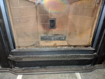

Have you removed the brick panels from inside the fire box and cleaned behind them ?
If not it is a great spot for ash to pack it in and reduce air flow through the stove
Happen on my stove thought it was the combustion blower but just ash in the passages
Yes, one of the 1st things I did when all this started. When I did the deep cleaning there wasn't any Ash anywhere, I cleaned the entire stove inside and out. Typically all my problems have been solved with a good cleaning but not this time.
