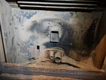

A few more data points. I took the bricks off again and gave it another good cleaning. It was pretty clean but there was a ton of creosote on the back wall which is very unusual for my stove. I've never had creosote on my back walls when cleaning, it was very hard and there was a lot of it. I had to scrape it off with a chisel. The other thing is the glass gets very dirty no matter what kind of pellets I use. The glass always gets dirty but not like it has been since this issue started. It get's dirty quick , and it's a thick coat of black crap. I believe it's a air or vacuum issue but now I have to figure out where the problem is coming from.
Yes you have a vent restrictionor blower speed or intake problem.
Did you clean that chamber to the left and right behind brick small opening that go to combustion blowers
Not only do I get ash from there but I have found critter nest, acorns you name it.
Make sure cap is not plugged
Make sure air intake is clear.
Hell if you want to be sure take stove outside and blast with leaf blower
Sent from my HTC6545LVW using Tapatalk

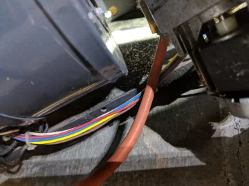

Adding another pic. I'm still concerned about these fines I keep finding at the baser of the auger near the convection fan opening. I'v cleaned back there every time I've pulled the stove out to check something and the next time I look, the fines are back.
Well if you think the vent is clear and all passages clean there is no way of telling if it is a combustion blower issue without checking vacuum from the firebox.
If you have the correct vacuum
Have you checked the auger feed?

Today I used the lint eater and cleaned the chimney pipe, I also did what you suggested and shot the chimney pipe with the leaf blower from the inside and I still have the same issue. If I put my hand near the quick connect and the wind blows I can feel air getting sucked up so I'm not sure if that means the cap is ok. There's not much more I can do until I can get on the roof and look at the cap. I looked with binoculars but couldn't tell if there are any issues up there. Tomorrow my friend is bringing me a vacuum tester tool as well. I'm going to test the vacuum and get on the roof and check the cap. Until then I'm done, this has been consuming me for about 3 weeks now! I intend to keep the stove off until then, the stove does stay lit but the flame is not acting the way it should and there is no where near the amount of heat coming out of the stove that there should be. The heat is lukewarm and not hot at all I'm just wasting pellets and electricity at this point because there is very little heat coming out of the stove. It's not working at all how it should be.
The fines are kind of normal
But if the bushing is warn then more will fall through.
Most larger hardware stores have bushings for about $5
