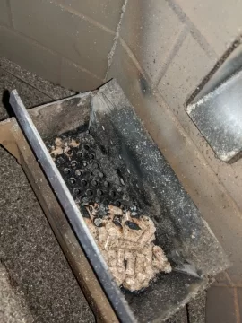

Enviro Milan wont stay lit - Burn pot full of pellets

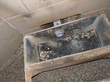

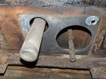

HT beat me to it- it does look like the burnpot liner isn't sitting down all the way- when it sits in the burnpot air comes in through the big pipe on the right and up through the liner holes. Could it be yours has distorted or something in the burnpot itself to keep air from dispersing into the burnpot liner as its supposed to? The convection blower flap is only for the uneven warm air being delivered into the room, not this burning issue... did you say you had a break in the droptube area? Could that affect air flow anyway coming into the burnpot and liner??

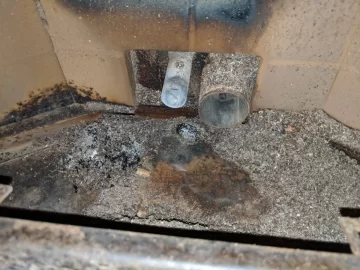

There was no break in the tube, there's a pic in a prior post. The welding had chipped off the top of the tube, I've since patched it with cement at Enviros request but I still get the same issue. I may mess around with the burnpot a bit because there may be something distorted?
This is for sure an airflow problem but I (we) can't figure out what's causing it.
Definitely need to pound out liner and get it seated down to where the holes are below burn pot holder
Sent from my HTC6545LVW using Tapatalk
Was looking at the pix- did you take the air tube and ignitor tube cover out? That pix looks like stuff was removed after you took out the 3 cast pieces? It looks like an air flow issue, dark exhaust, carbon everywhere.. seems air is not being directed through the burnpot and liner correctly..
Yes I took the cover out to clean behind it, and blow behind it to be sure there was no blockage. I also took a pipe cleaner and cleaned the pipe to be sure there was no blockage. Your observation is dead on, I've had the stove for 6 years now and I've never had dark exhaust or creosote build up behind the wall until this issue started, the crap you see all over the wall in the pic has never, ever been there before. Normally I clean the ash off the wall and there is no creosote or darkness anywhere. Since this issue started every time I take the back wall off it looks worse. Also - the inside of the stove get very dark and dirty and glass gets dirty quick. There's a blockage or break somewhere but short of taking the entire stove apart I can't find it. I've cleaned until I can't clean anymore.

This seems to be the consensus so I'll bang it out some more and see if it helps.

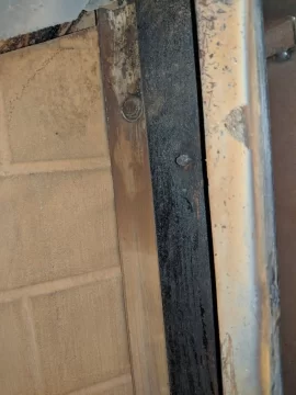

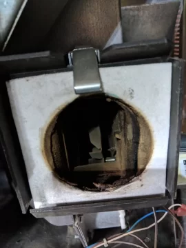

Might as well add more pics in case it helps.

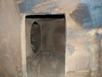

At this point i think the stove has to be taken outside and do a major cleaning. Then when you think you’ve cleaned everything hook a leaf blower to the exhaust port at the back of the stove and let her rip. While blower is running tap on the firewall with a rubber mallet to loosen any crap that might be clogging things up. Then run the stove while yoh have it outfide and report back
Crom his photos it looks all clear
Just not sure of cap
Agree but the poor guy has done just about everything but the LBT
Reactions: md2002
He did blow the vent from inside because snow on roof
I’m sure his liner is good but the stove is clogged up somewhere. Being an insert it’s not the easiest thing to do but doing it will confirm the stove is indeed cleaned and cleared. It would be my next step
The snow has cleared and I have been up to the roof, the cap is clear and I've done the leaf blower trick, I also blew as much as I could with a shop vac in the house. If this isn't fixed soon the plan is to take it outside once the spring hits and use a leaf blower on it and take it apart, completely apart. the ONLY thing I have yet to take apart is the auger and all the metal directly behind the stove, where the convection fan blows the air through. I'm pretty sure the stove can't be cleaned anymore without taking it apart piece by piece.

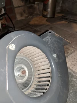

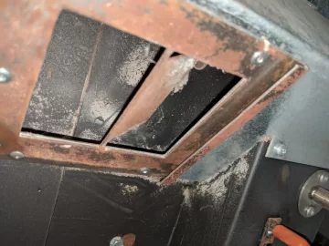

I had some more time to work on this last night and I hooked up the voltage meter to the convection blower to test that and it tested fine, I also looked at the flap mentioned in an earlier post and I moved that a bit. I replaced the ash pan gasket (even though it's only a year old) and banged out the burnpot liner so it sits all the way in the burnpot. I also cleaned out the hopper of fines. The creosote is getting out of control, my stove never had it and now it all on the back walls (as you saw in the pics) and is moving it way to the side of the stove (pic) and on the glass. This is very unusual, my stove NEVER had creosote build up. The air flow is messed up. I also had some strange black ash this time around.
The results weren't much different, the stove burned on setting #4 the whole day but would not burn on setting #3. I turned up the exhaust motor setting from the #2 default to #3 and then #4 and the stove seemed to burn on setting 3 for longer but it eventually went out.
Since the nice weather is coming this is no longer urgent so I'm going to stop using it and take it out into the garage when I get a chance and run it with no air restriction and leaf blow the heck out of it. I'll keep everyone up to date in the rare case I figure this out and it can help someone in the future.

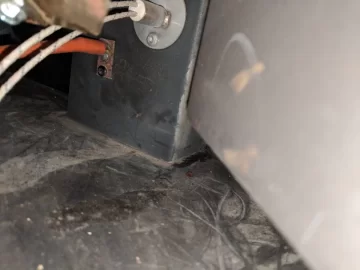

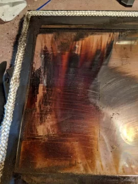

Added some more pics because I can.

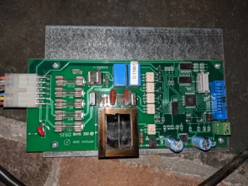

Now I have a whole new set of problems. After testing the convection blower voltage I forgot to unplug the stove and I dropped the lead on metal and caused a spark - the stove still seems fine but the convection blower no longer spins. I'm hoping it's a fuse. The convection blower thread have been stripped too, probably from taking it off so much. Do those helicoil things work to fixed stripped threads?
Im thinking they are sheet metal screws and helicoil wont work. Might have to try a larger screw
