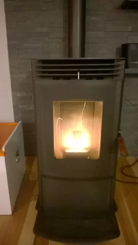

Here is a pic of the Mini

Those that don't touch their stoves for a week may have a different burn pot setup like a bottom feed design used on Harmans or a quad with a trap door lever to dump ash from the pot. Top feed fixed pots tend to hold on to the ash. A quick scrape with a small tool one or twice a day and all will be well.
Flame looks nice and vibrant. Nice looking stove.
