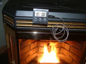

Ok, still more testing, WOW ! i would not have believed the difference in pellets as far as heat range.I was finally able to get my hands on another brand of pellets,over the LG-Granules Brand suggested by both of our pellet stove dealers.Well, so much for the frowned upon KENT BLDG pellets,i Like em', i agree they are consitently longer, with prob 10% of the pellets being approx 1.5 inches in lenth, but for the proven heat output from them as you'll see in the attatched pic,thats gotta make a diff come mid winter.All test results were done on a warmed stove with min 45 mins burn time,auger speed set to max, fan speed to 50% , damper 1/2 way open .Flame appearance seems to be similar, just heat output diff of 100 degree's with the (Cozy Comfy) being superior. Any input Ken?? loL
I think you'll find that you'll also consume more pellets. Since the pellet delivery is not really by weight but by how many get augured in during a feed cycle, longer pellets likely feed more total pellet mass for a given auger setting. Consider that your auger allows say 5 seconds of pellet drop on a feeding turn. So both pellet brands will drop about the same number of pellets (perhaps a few more of the smaller ones due to compaction density), but if the longer ones are consistently say 20% longer, you'll actually be feeding 20% more wood into the burn pot. That being the case, you'd get more heat (you're burning more wood) but you'll also run through a bag quicker. A proper test would involve weighing the pellets fed over a test timeframe.

Wow, 56, wondering if the diff may be in the 3 sec module as opposed to the 1 sec garbage i have in.My test results after last nite were totally opposite.Very dissapointed in Eastern Embers, (well not totally)Managed to Grab 2 bags to test with at Home hardware,ran them on Med from 12 yesterday, till it Ran dry at 2PM this afternoon,yeilding 26hrs burntime and a temp of only 200F from the digital thermo, Ash was considerably more then LG Granules, but Less then Cozy Comfy. Not sure if i wanna cry or laugh, as i just ran to Canadiantire and ordered a Pallet on there sat sale for $4.99/Bag, with a 20% Manditory deposit, well, if there Eastern Embers, and i so far don,t like em, it shouldn,t be hard to sell the pallet at $4.99/Bag. But i'm def Leaning towards a pallet of Cozy Comfy for my best heat Value, next step is to test Runtime on a bag tonite of the C.C and see how they compare that way...Before i change the timer..

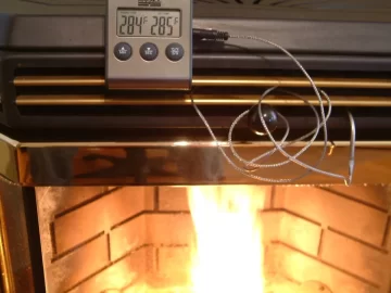

but, for the EF3 owners in here (with a 3 second timer...sorry gutterboy,lol). What does your flame look like with feed rate at medium? Mine seems to be (most of the time) close to picture 2 above, while burning "lower" for the other times. As I'm getting to the point where we will be leaving on 24/7 (we did last night and all day today) I'm still unsure if it's burning as it should: although I'm fairly sure it is.
Last night I turned it down to the 11 o'clock position and the flame was nearly non existent, which I wasn't comfortable leaving it at, so I left it on medium....

you will need to adjust the air when you turn the feed up and down to get the right air to fuel mix
While we are talking apples and apples here, the apples are Macintosh and Gravenstein. That is to say, that what determins the flame is the pellet feed and the air to the flame. We can all achieve a burn consumption of a bag per day(more or less). The difference between the two auger timers will determine the dial a fire knob position to achieve that burn. For me, presently with the 1 second timer module(3 second one on order), I need to set my dial to about the two o'clock position; while you. with the 3 second timer, may burn up a bag with the knob set at 12 o'clock, or mid range.

hi gutter i couldnt log on from home last night. if your enviro is working right it should burn at min 280 to 300 F max with pellet feed turned all way up and damper rod about half way out using eastern ember pellets. my enviro is about 3 years old in the winter i run 24/7 except shutting down for cleaning every couple days. if you bought you pellets at canadain tire that are on sale this week you are in luck the brand they have is lignetics and i tested them last night.we have a clear winner here over all brands available in eastern canada! i burned the lignetics for about 4 hours last night with feed on high fan on hi and damper rod out about half and temp was 370/380 F. i was gonna do the deal pierceys building supplies had on spreading the payments over 5 months on 2 pallets full of eastern embers but 70/80F difference and fact they are on sale i will be heading to canadian tire.thing i found with burning eastern embers on high is burn pot would build up not so with lignetics.

Yep...well aware of adusting the air :)
Anything under the 12'oclock position and I get a poor burn, regardless of what I do to the air...

hey gutter unless your stove doesnt burn as hot as mine. you should get at least a min 350 F on high fire will go to 370/380F as i stated no BS! i tried 2 different thermometers with same reading. i bought my winter supply yesterday at canadian tire based on higher heat output than eastern embers and other 2 brands.( supply at canadian tire went fast i would have missed out if wasnt for your post here). let us know your temperature findings.

Where did you place the thermometer on yours,i'm not saying i can,t get a higher Heat reading in a diff spot maybe, but as you can see in the pics, my probe is in the heat exchanger,as it reaches the room.
BTW just installed the new 3 sec timer at 11:AM today,set it to approx 8 O'clock position and left for the day, just got in at 4PM and was soo relieved to see it still plunking away with a nice burn gowing and a comfortable 125 F Reading with probe.So far i'm glad i got the 3 sec timer(Pellet1).It will be a relief to go to bed tonite with auger set to 9 o,clock and hopefully still see it running in the morning.Fingers crossed..
