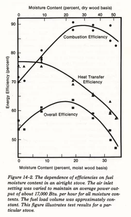

    Touching on this concept again, BG, I thought I'd include this statement from the author of this study (taken from his book "Solid Fuels"):
    [​IMG]
    A chart from the same book is attached below. I find this one that graphically compares the dependence on moisture content of various types of efficiencies to be very revealing.
    Combustion efficiency actually increases in a linear fashion as moisture content increases, up to about 20% MC, then continues to increase at a slower rate up to a peak combustion efficiency of close to 90% between 25% and 30% MC, after which it begins to decline sharply. However, at no point does combustion efficiency drop below 85%, even with wood that is 50% MC (33% water by weight, or "wet-basis").
    Heat transfer efficiency OTOH drops rapidly in an almost liner fashion as moisture content increases beyond 10% MC, and drops to less than 60% efficiency at 50% MC. This is because an increasingly larger proportion of sensible heat is sent up and out the flue as MC increases.
    Overall efficiency (the heat you actually receive in the living space) increases as moisture content increases up to about 18% MC, then drops precipitously with increasing MC after that point. Still, the overall efficiency remains at 60% or higher throughout the range of MC from 10% all the way to 30%. Enlightening to see that the highest overall efficiency of a conventional air-tight stove is about 63%... the same figure the EPA assigns to all non-cat stoves that pass the emissions testing. Dirtier burn than the new stoves, but same basic overall efficiency.
    Notice how he includes both dry-basis (top) and wet-basis (bottom) figures in the chart. You can use this chart to visually convert between these two commonly used ways of expressing MC.;-)

    Good points as usual, BK. But let's look at the real-world conditions under which this data set is true. Specifically, an airtight stove (no secondary air), air inlet setting varied to maintain a 17k btu/hr output, and small wood piece size relative to what is normally used. With combustion efficiency peaking at 30% MC, that says to me that the moisture content was essentially the main mechanism being used to slow down the pyrolysis rate to match the capabilities of the stove to burn it. Change the target output power, or change the appliance to a modern one, and a completely different set of curves would result - for the latter, more likely peaking at a lower moisture rate and a higher overall efficiency.
    So, as you said earlier, it really shows that the appliance factors predominate, and matching the fuel MC to the stove capabilities will give the best efficiency.

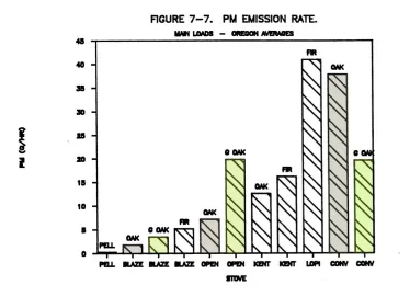

    As far as the PM emissions in the 1983 study, here is the chart that shows what went on. In the conventional air-tight, PM emissions/hr while burning green wood were almost half what the seasoned wood figures were. The open fireplace OTOH had 3 times as much PM burning green as it did burning seasoned. The green wood burned much slower in an uncontained (and therefore much cooler) environment, so again, burn rate dictated PM emissions.
    The Blaze King results were the reverse of the conventional stove, with half the PM emissions burning seasoned as it did burning green. But look how low both numbers are compared to the conventional air-tight. Th BK burned the green oak at 1/12th the emission rate as the conventional burned the seasoned wood. Clearly, this shows how much more important the appliance is compared to the wood. Which is why the author said so in the report.
    Precaud, as you can see in the attached chart below that was taken from the report being discussed here (which BTW was written three years earlier than the book), the term "emissions" was alive and well in 1983. Times really haven't changed that much after all. Wood burns the same as it always has, but the appliances and appliance operators have changed over the years.
