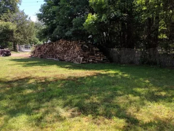

According to the kuiken site, its binder free. Hopefully next year (pic of my pile attached) I'll be totally set
You may want to re-organize that stack to only 2 rows deep, also the shad isn't really that helpful due to the sun blocking it, but more importantly its acting as a wind buffer, reducing the optimal drying.

I can definitely make it two rows, unfortunately morning sun is what I have to live with as that location is all I have. I could change the location of course, but that would require a new wife first haha
That's my issue wickets . I only get morning sun and not lots of room. I'm three rows deep and 60plus feet long .
