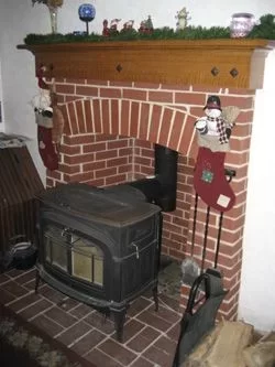

Do you have any pictures of your stove and chimney?

Ok guys, I really need to get this thread back on track. I know how threads can wander, but I really need your help in trying to solve the problem. Here is a ground pic of my chimney. The brick is in excellent condition. The staining on the front of the brick is new this year. The staining on the flashing started to appear last year before we had the chimney relined. I hate the look of the new liner cap. It looks horrible up there. When I get a chance I'm going to get a new one to replace it. It's hard to see, but currently the openings in the cap are only 50% open. You can actually see the creosote trying to drip from the cap.

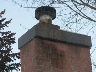

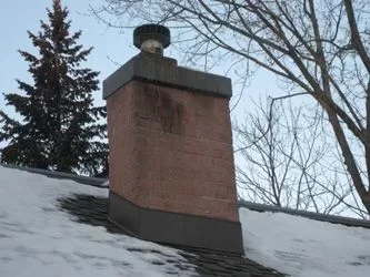

Ok, here is the existing installation. You can see the new work because it's a darker shade of black.

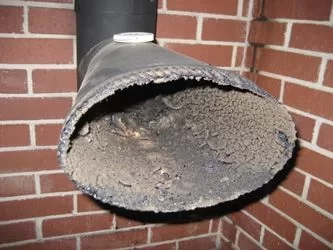

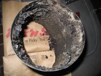

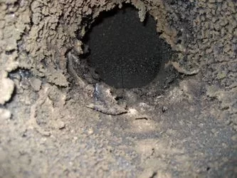

This is the adapter from the stove to the liner. The creosote started right at the cast iron stove adapter. By the back of the adapter the creosote was a good half inch thick. The creosote was loose and flaky. Things might have been worse, but the fire got into this adapter over the weekend which is why why shut the stove down.
