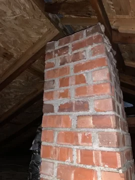

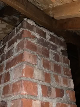

Other option would be to let the Sweep do the install, but if I don't like the liner specs, ask if I could order my own liner and go with the rest of the estimate. He did say he doesn't like to work with the add on liners because they snag more readily. I have seen pre insulated liners that have the outer covering of aluminum and a liner with steal on the outer layer. I would like a 1/2" insulation, as there are combustable next to the brick chimney, as it goes through the floor, ceiling, and the roof. Am I right in seeing this as a problem with wood next to brick chimney, needing insulation of the flex liner?

- I would like a 1/2" insulation, as there are combustable next to the brick chimney, as it goes through the floor, ceiling, and the roof. Am I right in seeing this as a problem with wood next to brick chimney, needing insulation of the flex liner?
