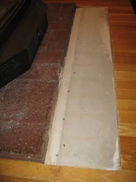

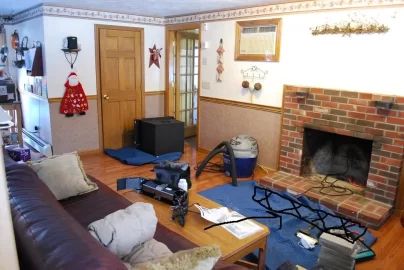

I need to extend my hearth 9" to meet the requirement of 18" from the glass. 1/4 inch Durock has already been laid down and I have another 1 1/4" inch to work with to reach the required R value of 0.6.
From Regency Manual
* Hearth thickness of 0.5" with k value = 0.84",
r value = 0.6 or greater.
I have been to several hardware and masonry stores and no on has heard of Micore 300. One stove and stone materials shop sold me Permabase today which I found out that I can not use in several threads.
Even if I went with:
- Durock 1/4 inch .10
- Durock 1/2 inch .20
- Slate 1/4 inch .025
0.525 K Value
This would not give me the required 0.6 or greater. I am not sure what other options I have to get to the required 0.6 R.

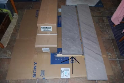

I'm not sure if this will help at this point but I'll share what I learned. I just had my Hampton HI300 inspected and passed this morning. I was concerned with my extension but it passed. My manual stated "Thermal floor protection not required if unit is raised 3.5" min. measured from bottom of stove. At this point the standard ember floor protection will be required."
In my case the fireplace floor and hearth height is greater than 3.5" so I only need standard ember protection for the hearth extension. I am 8" short from the 18" extension mark so I bought a piece of brownstone to lay directly on the floor. I plan to have a wool rug on the hardwood floor and then lay the stone on top of that. I currently have the stone resting on 1/2" wood boards so the stone is not in contact with finished wood floor. The LLBEAN wool hearth rug is due in any day now.
I think the key difference here is the 3.5" of hearth thickness. Your picture suggests less than 3.5" but I can't be sure. If that is the case, you will need to meet the R value stated in the manual.
I hope this helps.
Good luck!
