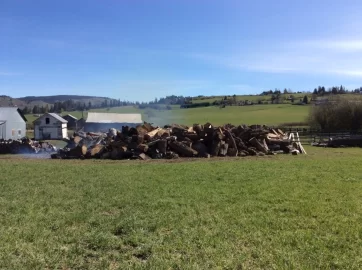

I logged for a long time and then had my own residential arboriculture company for a decade. I've burnt more giant piles of cottonwood, Lombardi, Chinese elm, Manitoba maple and various other junk woods than you could shake a stick.........or a match at!
