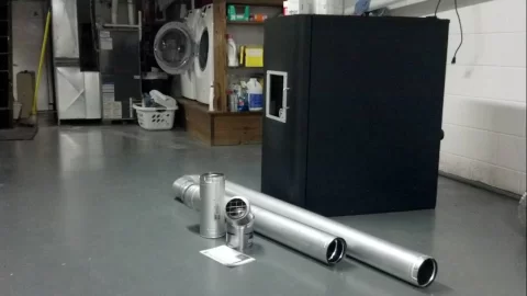

I have finally decided to install the furnace in the basement. Was going to sell it after installing a Englander 30-NC woodstove this Fall. But after much debate, it is decided.. Its going in..
Drove to Kinsman Stoves and got my 4" venting Yesterday morning. Always a pleasure at Erics shop. Got to see the new CAB -50 heatilator. Its not just a BBB like the Big E or other models like that. It actually a good looking stove. Great looking flame and great heat output..
Anyways.... I got a good start this morning. Got the furnace downstairs and everything marked and lined up. I did not buy a thimble, as I am going through cinder block. Just as I was getting in the Groove... I received a phone call from my local hardware store (I was just there and rented an appliances dolly). They called to inform me I won there raffle. The raffle was for a Husqvarna chainsaw w/ hard case, bar oil, mix oil, and 2 hats. I was so happy I won.. Even though I have a fee chainsaws. You can never have to many. Drove up, returned dolly and had to do a Photo shoot. So......
I didnt get much done. But it has begun. After some more measuring, I dont think I am going to use the duct work that I received with it. Going to call the Company that installed the New Trane furnace and all new ductwork a few yrs back.
So this will be an ongoing thread and I will try and post a bunch of pics. I did the woodstove install and was pretty thorough with it. That way when someone searches for the Fahrenheit, they receive some of the info they are looking for. The ductwork may take a week or 2. As I have yet to contact the company. Until it made it to the basement, I thought what I had would work.

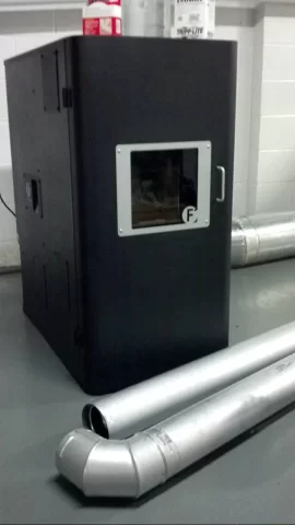

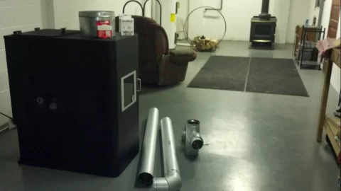

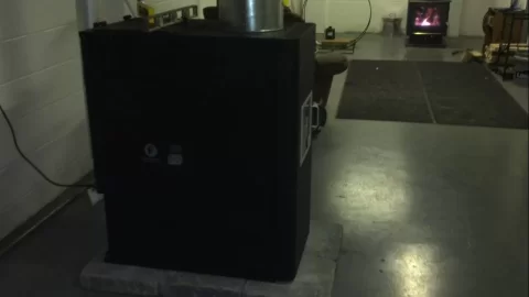

Here are a few pics. Just of the furnace sitting in its place. The idea is it will pull the hot air from the woodstove and circulate it throughout the upstairs. As its kinda hard now. If its above 40*, the woodstove can handle the duties.
Sorry to keep rambling. So excited about winning. Seems like I never win anything. Oh won a Ipod touch at my Christmas Party last night too.... Stoked!!!
More posts and pics to follow in the coming days/weeks. I want to done right and for the deal I got on it. I can stand to spend a few extra bucks on a Good install... And the Avatar to return to a Pellet Fire, rather than the Wood Eater...

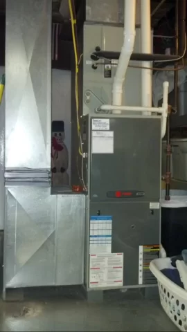

Also a Pic of the Trane LP furnace thats going on yr 4 unused (once in Fall and Spring to make sure the burners work) still need the blpwer for A/C, but no heat needed.
Im good without Propane... Thank you very much. 2yrs and still about 50% in the tank. Used to use 3-4 tanks a yr ($3,800) now one tank every 3-4 yrs (still cook food with LP)

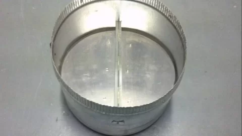

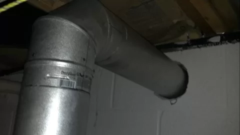

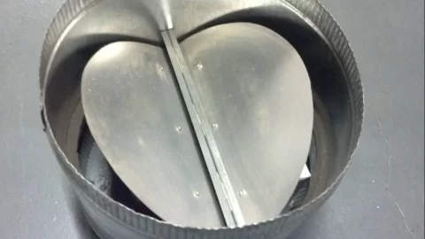

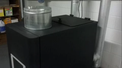

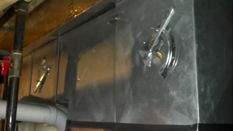

Here is the Damper set-up... There is a back-draft Damper for the Fahrenheit and when our new Trane furnace was installed (all new insulated ductwork also) after a house fire a few years back, they installed a few manual shut-off dampers. I still have to install the main trunk from the Fahrenheit to the North side main duct. I was going to have the installers of my trane do this, but I found the materials and it seems easy enough. I have done all my installs, along with a few friends and my fathers pellet stove. The dampers are there... And thats the hard part..

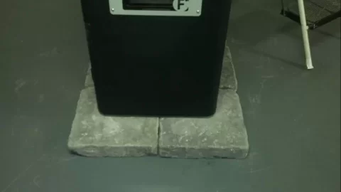

Also laid down some brick pavers.. Our basement flooded a few yrs back. This is what ultimately led to our house fire. We went a few days without power a few days and our basement flooded. i left some candles in the basement to watch the water level and keep an eye on the New back-up pump (Ran continuos for 2 days). After falling asleep on the fold out bed in the couch (In front of our Pre-Fab fireplace/only heat source), we woke to a house full of smoke. One of my candles had burned down and it had lit the plywood bench it was on (Shame on me).

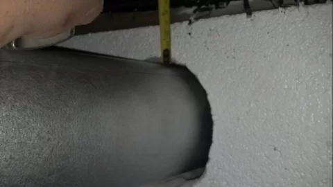

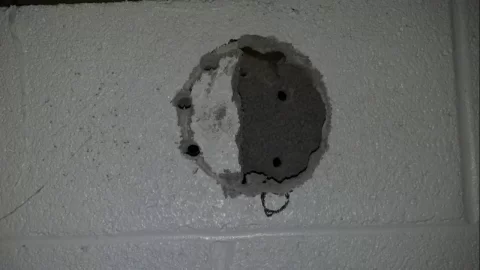

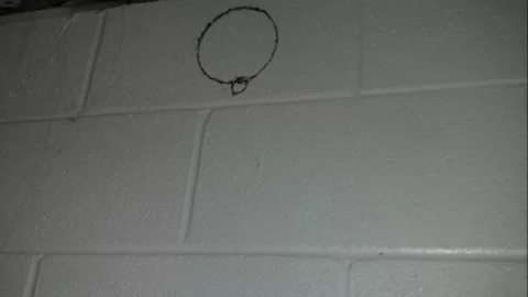

I have blasted the hole in the wall tonight. I didnt have enough time to finish it before the kids went to bed (Dont want to make a lot of noise, as the Furnace is right under there rooms).
I have 1.5" of clearance between the pipe and the top of the cinder block. Which is more than the Pipe Manuf suggests (by a 1/2"). I am still going to install a steel plate above the horizontal pellet vent. Even though the vent is about 4"-5" above the insulation, I am still Paranoid (You would understand if your home caught fire because of your own stupidity).
So all I have to do is seal the Stove appliance adapter, then seal all joints, and finally install the steel plates I have made to "finish" the holes on the inside and outside. I have 2 plates that are about 8" x 8" and I have a 4.75" hole cut in them. It will look like a thimble once installed. Because I went through block and exceeded CTC I didnt buy a Thimble.

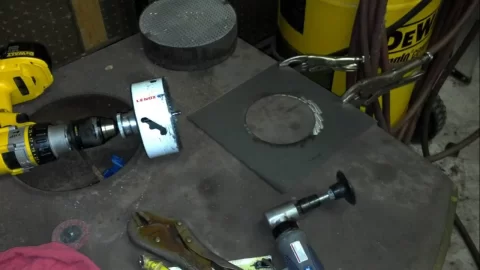

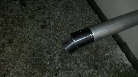

Because it was Thanksgiving today, I didnt get much done. We were in Youngstown at the In-laws all day. Got home about 7. So I had enough time to Fab up my Home made covers. To make it look like I have a Thimble.
If I didnt do this, I would have to mortar or thinset the pipe in the wall. Now I can just use Tap-Con screws to hold the plates and then a small bead of silicone to seal.
I still need to run the Romex from the Main Circuit Breaker Panel to the Stove. Also have to finish the HVAC. I bought a 7 day Programable T-stat from Lowes (Hunter brand/All touch screen). Still need to run the wires for it.
I only got today off. I have to work tomorrow and the weekend straight through to next weekend (Bummer). So this may take a little longer than Id like. But its Progress. Something I was not making before.
Still need to paint and drill holes in the plates. But I got something done. As long as I do a little everyday..........
