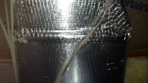

And to the loose wires across the ducts, (Jay-Smoke) the entire house is wired this way. Nothing drilled through the rafters. Asked about it when purchasing. Was told its legit. As long as the junction boxes are sealed. Its been that way for 17 yrs. When we had the fire, they had to replace all the insulation in-between the rafters, all the HVAC, and some of the electrical and plumbing. When they did all that, I think they made it look a little worse. But Insurance agent said it was A.O.K.... Just an FYI. I have looked into it because I thought it wasnt right. My little township out in Bo-Dunk Ohio dont care much about anythin???
Anyways. T-stat hook up tomorrow and then a little more sealing. Found where they half @$$ed some of the ducts feeding off the main line. Only heat taped where you can see. Top 6"-8" across, where you can see, has no tape and it blows the flame of my lighter out. As much as I like this, I hope it only gets better. Long Post.......

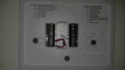

Jay, I got the T-stat installed today... One problem. It doesn't work. I thought I had it hooked up correct, but I guess not. Its on the RH and W1, then there is a jumper wire from Rh and RCR (said to leave jumper in for 2 wire system).
Never used a regular t-stat for a Pellet stove.
Someone please correct where I have gone wrong. The furnace is set to T-stat (Was off and cold when I hooked it up) and the wires are hooked up internally.
Thanks for any thoughts. Its a touch screen hunter model. 7 Day programmable.
Did you turn the controller on the furnace on after hooking every thing up?
Then there is always the ever enjoyable break in the wire going to the t-stat issue. Remove the wiring from the screws (or whatever) on the stat and twist them together.
Is the stat in heating mode and are all of the programming slots set to allow it to operate. Then we have the is the temperature such that it should call for heat at all issue.
Yep. Furnace set in T-stat mode, cranked the temp to 90* on Thermostat. All looks good with the actual stat and wires. Im guessing that a 2 wire system is a 2 wire system (hooked up per operating instructions).
The break in the wire could be possible. I was pretty gentle running it. Just bought it the other day. Its a standard 2 wire thermostat wire, sold at my local hardware store.
May try and twist the 2 wires that go into the T-stat and see of that will fire the furnace. If it does, I know its my wiring of the stat. If it doesnt, then its in the wire or something may be wrong with the terminals in the stove. Its about a 25' run of wire.
Will check it out and post the results when I get home this evening. Try and post a pic of the wiring.

hey dex, i have the same stat i think model # 44668 or 44660. just hooked it up 2 months ago. you dont need the jumper for pellet stoves just go to RH and W/B. does it call for heat? should be a little flame next to the word heat.
Its a 44860. Pretty nice unit. Just getting home, but taking the Wife out to Dinner. So all testing will be put on hold.
So remove the jumper?? Roger. Will try that when I return. Parents are gonna watch the kids for a few hours. 1st time in forever we have went out alone. Gonna be nice.
