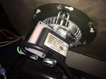

- The P61a combustion blower had a bad bearing. Sounded like a bag of marbles. Still under warranty so I brought it to my local dealer who gave me the new one. Nice and quiet now.

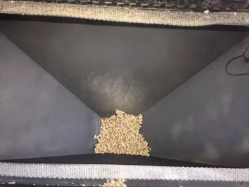

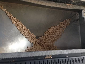

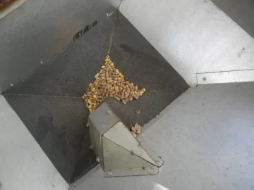

I need to prep the hopper so that the pellets don't stick to the inside when it gets low.
I also need to buy a generator and get it set up.
Couple of options for making the hopper slippery. I like graphite paint. Works great on the auger too.

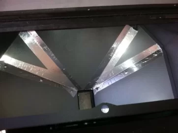

this what i did works great..pellets all burn now[Hearth.com] Farmers' Almanac s Predicts Nasty Winter - Is your stove ready? If not what are the improvements?
yeah they call it foil tape..this one is made by nashua...then i took some pledge furniture polish to the whole thing..they slide right down now.
OK, thanks i have some at home. Looks like you did the creases ill give it a try
