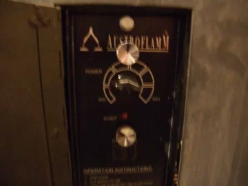

Maintainance-serviced the firebox(rust & paint),2 new bearings in combustion blower,finally had to remove the original welded in studs that hold firebox plates in,they finally lost enough threads,complete stove and flue cleaning.As far as "upgrades" I made both trim adjustments external.
