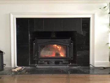

Hello ctwoodtick
I threaded two screws into the two outside holes and it did nothing. The insert still ran hot. Once everything cooled yesterday, I took off the door and looking into the damper vent using a torch, I confirm the damper is sliding correctly. As a quick test, instead of a screw, I blocked the full booster air piece with fireproof insulation. The result, no more over heating. That was the cause!!

I took off the insert surround yesterday and left it off overnight. The amount of radiant heat into the room surprised me. Does the insert surround truly block that much heat? Has anyone left it off completely or, pulled out the stove one inch to let the radiant heat escape into the room.

Very glad that you’re having success. Keep me updated with how the fireproof insulation continues to work. I may try that at some point myself. Your second video looks like a good slow burn. My guess is that’s a nice slow roll of about 600 degrees stove top temp.
I’ve never run the stove without the surround. I’m surprised that the heat difference was so noticeable. I would have figured the masonry would suck up it’s normal amount of heat as usual.

fire on for two hours, and three screws in for the last two weeks. Thoughts On flame? I still think air is getting in.

yes, I’d bu curious about the stove top temps. You don’t look out of control in the video. Coals look brighter (hotter) than I’d expect on low. I’d expect more secondary combustion, but lots of factors could impact that. I know that if air was getting in around the door area, you’d see noticeably more soot buildup on the glass in the soots that air was leaking in.
