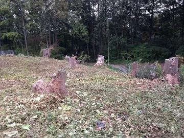

Happened upon a work crew in Frankfurt, Germany, yesterday.
Seems the technique is the same here, excepting maybe a bit more height diff on the back cut.

Not to Germany, but about 100 feet after felling a tree that didn't go where planned. That extra high back cut gets the chain out of dirt and grit that is near the base of the tree, also easier on the back and safer than bending lower.

I cut the back cut high like that also for reasons mentioned above. Also I figure if something goes wrong and I need to get out of there I can go quicker if I'm already standing straight. Then I go back and cut the stump.

I cut about the same height, but it is not the height to which I was referring. Note the back cut is at least 5" (13cm) above the face cut, or about one half tree diameter above the face cut. I usually only have maybe 2" height difference between the face and back cuts, even on much larger trees.

I cut higher so I'm standing. I can move faster standing if something goes wrong. Kneeling and with my knees, the best I can do is roll over.
I have noticed more guys are cutting at a higher spot on the tree and coming back and cutting close to the ground. The township guys just took down about 25 Osage trees this way. Can you believe they kept all that useless wood for themselves:). Oh well it takes 5 years for that stuff to season right. I would travel much further for locust and oak.
