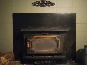

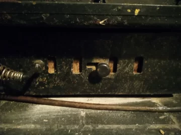

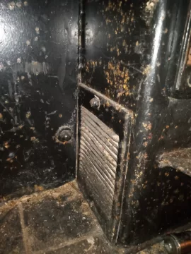

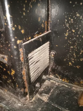

My husband inherited his dad's house. We recently moved in after all the remodeling was finished. The house sat empty for a little over a year.

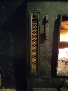

My question is does anyone know what brand of wood burner this might be? It has a working blower motor. It also has a small peek-a-boo window to check on your fire.
[Hearth.com] Father-in-law's Wood Burner[Hearth.com] Father-in-law's Wood Burner[Hearth.com] Father-in-law's Wood Burner[Hearth.com] Father-in-law's Wood Burner[Hearth.com] Father-in-law's Wood Burner[Hearth.com] Father-in-law's Wood Burner[Hearth.com] Father-in-law's Wood Burner[Hearth.com] Father-in-law's Wood Burner

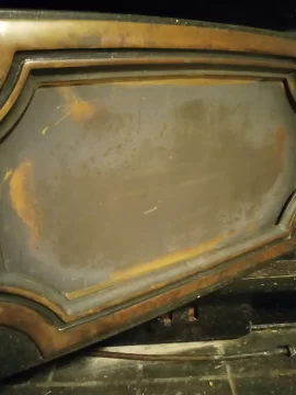

The more I clean it, the more the brass appears. I would love to have it back to the original appearance.
The house was built in 1940. Blowers I believe weren't available until the 70's.
My kitchen is original with a 1951 Crane Sink and metal cabinets.
Thank you in advance! Any information is greatly appreciated!
Reactions: Burnin Since 1991
Seems like a treemont insert.
Actually, no! All I know about it is that Buddy, my father in law, used it until he passed away a year and a half ago.
I was looking online for models and the only thing I found with this exact stove was a manual with the TAC model numbers and pics of them.
My husband used some Duraflame in it before we ever used it.
Like mentioned above, definitely have it inspected. Especially with older setups, there’s a greater chance that that insert was installed with no stainless steel liner for a flue. Or, it may have been installed with a stainless liner that only connects to the first clay liner of the existing chimney, which would require a more specialized and extensive cleaning than that of the an insulated stainless liner that was installed from top of chimney all the way down to connection to stove. That, and it’s always a good idea to have a “new-to-you” set up looked at for potential issues.

[Hearth.com] Father-in-law's Wood BurnerI found a picture of our Treemont on a Catalog online dated 1985 but not sure of which TAC model it is.
Also, did ALL models have a glass door insert? This one appears to be just brass.

There is a lot that can go wrong with burning wood, including your entire house burning down. Please take seriously the advice to have the wood stove and chimney pipe inspected. If your father-in-law was anything like mine, the installation will be subpar and the equipment will have been used long after it should have been scrapped. Baked on soot on the window of the wood stove is indication that he burned in a way that would lead to excessive creosote formation in the chimney, which will lead to a chimney fire (eventually).
Also, if you are serious about becoming a wood burner, please be sure to obtain a supply of at least 2-year dried wood with a moisture content of <20% on a newly split face. No wood supplier will have this type of wood, although they will all tell you their wood is "seasoned" and ready to burn (it is not ready to burn in a modern wood stove).

When you described the creosote buildup inside the door. My first thought was how much creosote there most likely is in the chimney.
Exactly! My husband burnt a couple of the creosote logs before we ever used this! I understand that we need a chimney sweep in a serious way.
