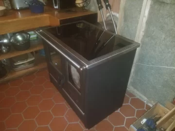

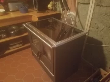

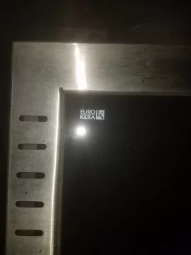

The ceramic top came in, USPS of all things. Imported from Serbia as well. The glass is actually made by Euro Kera, which I didn't expect.

Also in my excitement I forgot to mention I was able to start the fire with the bypass closed (oven engaged). No preheating required when there aren't holes in the cook top.
Reactions: heavy hammer
That is a great looking cook top, I really like that shot of the glow.
glad to see that it may have cured your start up problems.
let us know how the new top cooks.
Reactions: SpaceBus

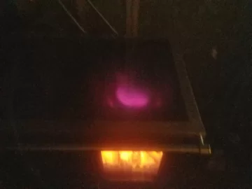

So far I boiled some spaghetti and it was pretty fast. The stove is even easier to control without the draft getting diluted from the cook top. The water coil also seems to be more efficient without an air wash. Even if the steel top had a perfect seal, the ceramic top heats up almost instantly and is way easier to clean.
It seems like the rear vent setup was design to be used with the ceramic top. The plate over the old top vent opening was not a good fit at all. Perhaps in time I'll have a better lid made with countersunk holes and a gasket for the steel top. Eventually we want to learn how to can fruits and vegetables and Obadiah's does not recommend that kind of weight on the glass top. Maybe a better idea would be to have a local fabricator make me a better steel top or put supports in the center so I don't even have to worry about it at all.
I'm also hoping the ceramic top will help me hold coals through the night. The stove held coals all night with a firebox full of hard maple, but my Morso can do that with softwoods with a bit more than half the volume.
The cookstove has become much more responsive and controllable with the glass top. I'm not really sure how accurate my IR thermometer will be. Perhaps an emissivity adjustment could make it work? My flue temps are higher and I've had very little smoke spillage.
The heat entering the room is impressive. I was not expecting this stove to heat the house very well at all. This morning when I woke up the house was 66 and outside was 25 df and both stoves were cold. I lit a medium fire in the Morso and got the cooker going for breakfast and refreshing the hot water. Fast forward and I have three windows open, but the cooker has been going since I got up with moderate baking fires. Outside temp is 35df currently with full sun. The rock wool helps, but most of my band joist area is uninsulated as are four stud bays. The Morso only gets lit in the morning and cold nights now.
Reactions: charger4406
I have no idea how accurate my IR thermometer is when checking the glass top, but with a 350-ish oven the top is 800df right at the firebox exit with a surface temp on the flue adapter to class A is 200df. This is with the ir thermo emissivity adjusted for black surfaces and glass surfaces respectively. I'm not really sure what to expect. The range boiler hasn't been as hot, but my wife is ill and has been living in the tub.
