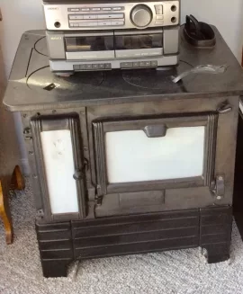

i had my grandma send over a couple of pictures. she has their stereo on top of it but put the handle in one of the plates on top. i didnt ask her to open it up as i know they store cd's, tapes and records inside. she says as far as she knows it goes back to the 30s. its in really great shape. the top plates are for adding wood. the big square door in front is the oven and the skinny narrow door in front is where ash is collected. there a shaker lever to get the ash to drop. shes says theirs didnt but her aunts big wood burning cook stove/oven had a place to put cold water into it. she remembers it always needing to have water but cant remember why.

That's a really neat stove. I think the side over the firebox has the "dog bone" so you can put a large basin right over the fire to wash dishes or laundry. That's what folks needed hot water for, aside from cooking anyway. I would have liked a hot water water reservoir on the stove but we couldn't find one that also had a coil for a plumbing system and also fit our kitchen space. I'm trying to figure out how to put a tap right off the range boiler that doesn't have a thermostatic valve for filling pots for soup, pasta, etc. I have mentioned it in passing to my wife and she gives me a crazy look...

That is a really compact cook stove. I wonder if it was designed for a small space like a train kitchen or caboose.

i asked her. the cabin up in michigan was on the small side. single bedroom, living room with fireplace and kitchen. did have a small bathroom but wasnt plumbed. had an outhouse to do your business in! sat on 80 acres! the cabin was used like a summer home. "indoor camping" is what my grandma calls it. built in early 1900s and this was the second stove. had a nicer home elsewhere. so that must be why its a smaller stove. when my grandparents brought it to their house they had a blacksmith bring it back to new condition because they thought theyd use it to heat their sunroom but ended up deciding on a gas stove instead. apparently my mom has dibs on it ;lol

It's a really nice piece either way. Looks like a good size oven.

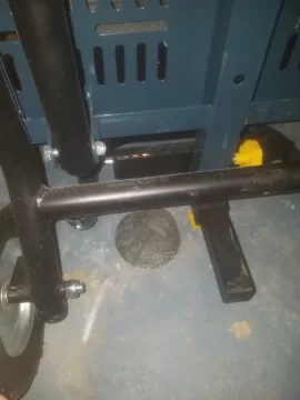

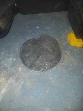

Perhaps also the tightness of the house is working against us. We recently discovered air coming in from the drain leading to our septic tank in the slab... Neither of us expected the house to be this tight since it's from the 70' and we did all the renovation work ourselves. The house is wrapped, several windows are new and the old windows were fairly nice in the day. This makes me think the interior chimney pulls air through the exterior into the house when the cooker cools down. My other stove is not a BK so I can't close it entirely, so I think it will always do this. This is what lead me to the draft induction collars, which I've read about here. I'd rather achieve the same effect with a torch or similar rather than another electric appliance, which is the antithesis of the cooker.
The water coil probably isn't helping either. An oak would also be nice, but this stove, along with most other cookers, don't have that option.
It might be worth investigating an HRV as a solution, or at least a valved air intake that is located near the firebox.

A air to air heat exchanger (HRV will help if you have an overtight house. This will bring fresh air into the house and reduce the negative pressure in the house. If you are pulling gases from a septic tank there is something really strange with the piping. The septic system should be vented to the roof with all fixtures vented to the stack and protected by a water sealed trap. If its raised bed system that needs a sewerage pump in the basement, the collection pot is vented to the roof and then the distribution box is vented with a "candy cane" vent outdoors . Pulling in sewer gases into an interior space is real bad.
Well, it's just an open drain into the slab. The previous owners ran the drain for the water heater into it. I've stuffed steel wool down to keep critters out. I do also have a vent that goes through the roof.
Either way, it wants to let air into the house. When the stoves are going its easy to find the holes in the house.
I attached some photos. Pay no mind to the rolling cart sitting over it, they have nothing to do with each other. This drain is in the plumbing/electrical closet.
