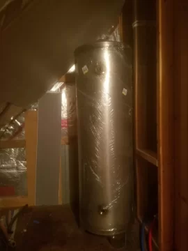

Good news, the range boiler fits standing vertically!

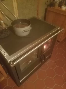

Had a smokey start this morning, but it's because I didn't put one of the lids back on while I was trying to light it... It wants to smoke out of the lids no matter what on a cold start, so I've been using a mapp torch to heat the flue. This morning I forgot to replace the lid that covers the top flue outlet position (a great spot to keep my French press warm!) and I'm sure you can guess the rest. I need to get a tiny butane torch or something, the full size torch setup is awkward.
Sometime this week a glass top will be shipping out! We will keep the painted steel top for canning or other heavy stuff. The ceramic glass cook top allegedly heats up twice as fast, so I shouldn't miss the removable lid. As I said earlier, the gaps in the steel top like to smoke on start-up, so I really don't think I'll miss it at all. The steel top heats up faster than the GE glass top that came with the house.

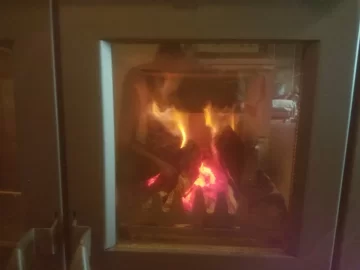

Once the stove is cruising with the bypass closed and dampers closed up the stove top hovers just under 600df in the hottest spot with a 200df surface temp on the flue adapter. The under fire air allows it to easily turn up the heat quickly after which I just close it back and use the air wash to control temp. I've only used the oven for roasting peanuts at 350df, but that was measured with the door thermo. It took about 20 minutes for 3 cups of large Spanish peanuts, which is abou the same as my GE set to 350, so maybe the door thermo is accurate.
This fire is oven on all dampers closed with 525df cook top peak. This stove is easy to control surprisingly. There is about 22' of stack from the flue outlet and I was initially worried about low draft so I ordered an extra 4' section of class A just in case. It is very unnecessary and I think the only reason draft is more of an issue at start is the water coil and the holes in the cook top. I think the glass top will make starting the stove much easier.

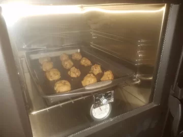

Just put some cookies in the oven. I'm hoping to get a second rack when they ship the glass top.

I'm hoping it will be here by next weekend. The cookies were amazing.

Can you regulate oven temp specifically, or do you need to use the stove's air controls to adjust the firebox temp?
Oven temp is regulated by a bypass and the firebox. There is an adjustable air wash and under fire air along with a fixed secondary manifold. With the intakes closed and the oven engaged (bypass closed) the cook top sits around 500 and the oven at 300df as indicated by the inside oven thermometer. The door thermo is only marked at 100,200,250, and 300 dC, but is pretty accurate. If I want more heat on the cook top or oven I open up the air wash and away it goes. The under fire air is awesome for establishing a fire, and that's about all I use it for. This stove will definitely burn unseasoned wood if necessary, but thankfully it's a non issue for me.
