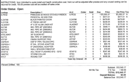

This is the first quote I received for purchase and installation of Blaze King Princess freestanding stove. New construction.
Quote does not include hearth yet (another contractor will provide)
GC quoted high number for "fireplace installation" so I asked him instead to manage woodstove installer as a sub and add his O&P
Any feedback on this quote?
I'm comparing it to my previous install (BK Princess insert installed into masonry chimney) - stove cost is similar but the chimney is higher than I expected. Any way you see to economize here? Should be a simple straight pipe up through the second floor and attic.

Ouch. The chimney pipe does seem high-priced. Do you know what brand they would be installing? Hopefully, it is top-of-the-line. For comparison, with DuraTech:
They don't need to install chimney with a stainless outer jacket through the house. Galvalume is fine for the interior passage. That would save a bit.
This is a really tall chimney. It's going to draft strongly. This should be tested. The stove will likely need a draft damper in the stove pipe to reduce the draft to factory requirements.

I'll ask him about swapping galvalume for stainless for the interior section
draft was not a problem in this same house previously. Had a BK Princess insert installed in the first floor, then ~30 feet of 6" pipe straight up. I was able to control the draft using the thermostatically-controlled damper; it never pulled too hard such that I couldn't control it.

You won't have any issue controlling a BK on 30 feet of pipe, these stoves shut down quite well, but that wasn't the reason begreen had mentioned it. With that much pipe, it's likely your draft will be at least 3x the max spec, which will affect efficiency and also subject the bypass damper assembly to higher likelihood of damage while operating in bypass mode. In some BK's, namely the 30 series, the likelihood of frustration with clogged combustors also goes way up on very tall chimneys.
While BK has their hands tied with regard to recommending a key damper in your pipe, the EPA prevents them from recommending any equipment other than that included in the testing, many of us have already shown that this is the quick and easy solution to keep your BK operating at peak performance on a too-tall chimney.
View attachment 313247View attachment 313248
we paid just under $5000 installed but that was a few years ago. too, labor and materials in your area might be higher than my neck of the woods
