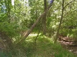

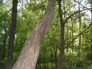

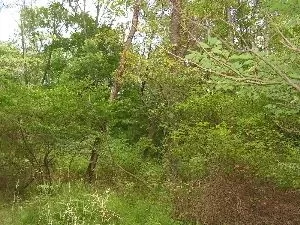

Here are pictures of the standing blow-downs.
Picture Tree1 and Tree1a are the same tree, about 12" in diameter. Tree1a shows the trunk is absent bark on the lower portion. This tree may be closer to 50 degrees over the horizontal, not the 60 degrees I first estimated.
Picture Tree2 is the other tree mentioned. It is more vertical, perhaps 70 degrees over the horizontal. It is also smaller, about 8" in diameter and is really lightly held, to my eye, by the tree it is resting on. I'd expect this to blow down in any high wind, but obviously has not done so yet.

Jerry you can do it brother...forget about a hinge cut. Just carefully cut two single notch's 16" apart on the underside then ...have a look see. then keep bouncing back and forth cutting a little bit from both notches. Try and do this from no higher than waist high when it looks like it starting to pinch then continue to cut from the top side.
When you're making a cut like this take your time cause the tree, when released, will want to smash your trailing foot...but it won't cause you're cutting it from waist high or below. Sometime the stumps will pull back upright...and sometime they won't.

do you have any pics of the top of the tree where it is hunp up!

In words, the second tree, the smaller one, looks like it could be pulled off with a small force. A manual come-along may do it if needed.

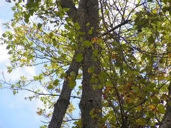

That first tree can be particularly dangerous depending on how it is hung up on top. If you cut it off at the base it could do near anything, kick back, roll around to the left or right, or just kick forward and plant the butt a couple inches into the ground. If you don't have ability to hook up tractor and chain, and the top is hung up real good, you'll likely wind up with the butt stuck in the ground and the tree still standing, just more vertical.
Before you do anything, make sure there is NOT any limb or limbs or other smaller trees that could snap, fly back, and nail ya on the head when you cut the main dead tree there.
I suggest you go to arboristsite.com and post your pic for better advice if you're feeling like you just gotta cut the thing down.

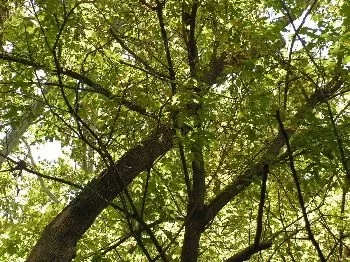

Here is what the top looks like for the two trees. It is hard to depict even with a picture. I'll add some words.
The small in diameter more vertical tree (right hand photo) is laying on the right side of the supporting tree, this one seems to have only two direction in which the top can move: to the right and down. The larger diameter tree at the flatter angle is in a crotch of the tree, so it seems it can move only downward, neither left nor right, at least not until is has slid down enough to clear the crotch it is resting in.

Brought down one of the subject trees, the one on the right, more vertical one, in the post above. I reported part of this information on another tread about Craig's list, but figured it needs to be here to...brings closure.
First thanks to all for the help, encouragement, and words of caution. I'm not hurt so the words of caution helped/worked.
I brought down a 40+ foot dead hardwood tree that had blown over against another tree. This tree “drop” had its risk factors and I used a manual come-along to control the pull down. As I didn’t have the strength even with the come-along to pull the tree off of its leaning position, I had to cut the tree in a “mock” take-down method, cutting a hinge - then using the come-along to develop enough force to break the hinge. Interestingly this resulted in the lower section coming free, and the tree leaning against its neighbor just slid down and stuck in the ground. I had to go through this cut and pull three time before the tree came down to the ground. Each of these three sections were about 3’ in length. In fact the final bring down required that I kept backing away and finding another tree to anchor my come-along as the final pull down was at a point that the remaining tree was light enough that I could drag the base (plow like) resting on the ground along until the top fell out off of its neighbor. I'd guess for all the work I got about 500 pounds of hardwood...still have to move the 3' sections, I cut on site, across a creek to my tractor/trailer before I can get them to the shed for final cutting into 18" lengths, and split and stack. Boy, getting that "free" firewood is a lot of work.
