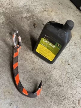

Will try to post photo of my favorite hook, which came from a very, very old cant hook or peavey, when I’m outside later today.
I bought this for hooking my winch cable to the far end of a log, to hook on the far end of the log and pull it the last foot onto the trailer, after tongs or choker does 90% of the job. But since then, I've found it very handy for rolling logs. Whatever you use, having it sharp enough to easily bite into the log makes setting it much easier.
This hook was part of an old peavey or cant hook, the ring slipped over a wooden handle. I can't read the maker, but can clearly see it was made in Bangor Maine.
I added the orange striping, after nearly loosing it several times in autumn leaves or on brown dirt. I'm a big fan of striped patterns on equipment used in the woods, since any solid color is harder to spot in a quick survey. Now, nearly all of my equipment is painted with contrasting stripes.

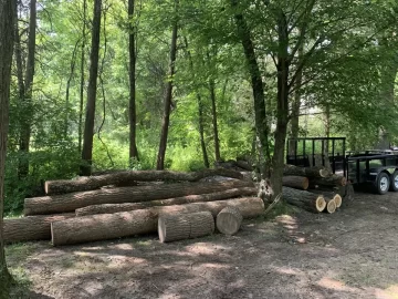

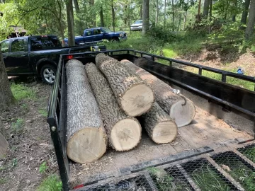

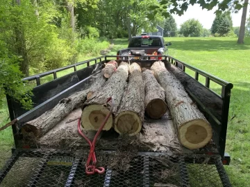

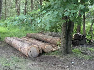

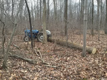

I was just sorting some directories of photos, and happened to come across these, showing how we stage in the field adjacent to the woods.
Dragging it out:
Staging in the field, back before I had a winch, and had to buck every round before individually loading into the trailer:
Staging in the field after I got the winch:
Bring it home and unload:
