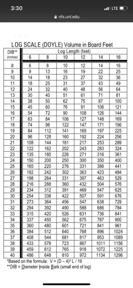

A lot of the wood is firewood, but I’ve been getting some nice sawlogs as well. Which brings me to my next question. I’ve been using this online board foot calculator on wood web. They list 3 different options for “log scale”. The options are
Doyle
International
Scribner
Do you guys have any idea which one I should be using? For instance, if I put in a log that’s 14” diameter and 8’ long, it gives me these BF numbers
Doyle= 50BF
International= 65BF
Scribner= 60BF
I’m not sure if one system optimizes the log for the least amount of waste or what. Basically when I have the Amish guy saw these up, it’s going to be whatever widths he can get in 2” increments

Seems like the most popular scale is the Doyle. At least that’s the one I see referenced most often.

We use scribner here for almost everything except pulp ( usually by the ton or kunit). It favors the mills with longer logs with taper and makes it tight with the shorter logs. They actually pay less the for the shorter length stuff. Some of this is because of the container ships ( export) but the local mills are the same. Years ago we cut some taller second growth around 160ish ft and they had us making longer than normal cuts like 48’s and the had us on some other scale that was more fair but I can’t remember what it was called. Poles ( power) are set up different as well as I’ve cut them up to 120’. We called swing cuts a Dutchman. Could just be local slang though. Basically any shallow undercut with a small face in the front will make them jump but you might want to make some side cuts to help avoid barber chairs cuting vertical can make the wood pull harder and can help swing side leaners or swing cuts( Dutchman’s?)

Ok thanks. Maybe I’ll use the smaller number just to be safe. I don’t want to cut too little. I need around 1200 board feet, but 1500 would be better.

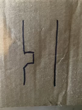

It was my understanding that the Dutchman is the notch cut, and the swinging Dutchman is that notch cut used with angled back cuts (triangle) to make the tree swing around. But my knowledge is just internet knowledge, so I’ll just throw that out there :)
This is the notch I’m using. Sometimes I do the little angled part at the bottom and sometimes not.

Do you use a normal back cut to fell the tree? I may try something like this when I know I'll have a hard time and don't feel like using the winch.
