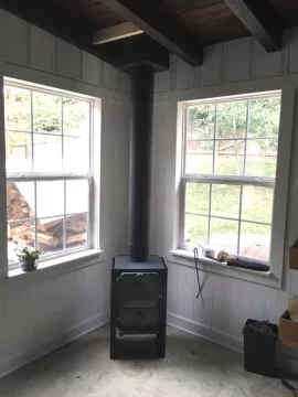

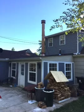

I know it's nothing compared to some of the beautiful parade of hearths on here but I'm super happy it's finally installed and working! We've waited a long time and it's already been a joy :) Huge thanks to Begreen, bholler and everyone else who answered my myriads of questions!
Introducing, our Morso 1440, Ventis double wall pipe to crazy tall Ventis Class A chimney. Installed by a local sweep.

Hey, that looks great! And you're going to be glad you did it right every time you light that little puppy.
Looks good!
Is it just the lighting and the angle, or is the class A a copper color?
Congratulations, it looks great. That corner of the house is going to be nice and toasty. If you split up some of that wood in half it will dry quicker. Then bring it inside and store it in some open rubbermaid totes or boxes. In a few weeks it may be dry enough to burn.
I noticed that too, had the same question.
Also, refresh my memory. Is the floor concrete slab?
Looks nice- Morso stoves are really pretty burning. Enjoy the warmth.
It is! It is Olympia's Ventis powder coated in their "copper" color. I wonder if I should have gone with black, but I think the copper is pretty too :)
Yes the whole room is a concrete slab :)

Haha thanks ;lol. My friend thinks the chimney is comically tall but I tried to explain draft to her a little ;). First impressions is that it does appear to draft well. When the sweep finished installing it he put his hand in there and mentioned that it already had a good draft cold, my husband could feel the air inside it rushing up the pipe too so I'm hopeful we will have good draft all winter :).

I thought so. You are good to go. That is the first time I have seen a copper chimney. Looks nice. I'm looking forward to hearing about hubby's and your experiences with the new stove.
Lol. I mean Chimney, Love the copper look.

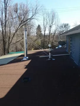

You're only a little taller than mine :)

How is your Morso 1440 working for you? I am amazed at how close to the corner and windows it looks in the picture. Is that 7" off the corners?
We are looking at a Morso 1440 for supplemental heat (and emergency heat) in the corner of our dining room. The Kitchen, dining room, and living room are essentially all open, and the dining room is in the center. Other than emergency use, it is primarily for "wouldn't it be nice to have a fire?". We like the small size and and close clearance that mean it can go into the corner without being in the way.
In our current house we have a gas fireplace that we rarely use. In our previous house, we had an open fireplace, which we enjoyed when we had occasion to use it, including when we had a long power outage in the dead of winter and used it to keep the pipes from freezing. I look forward to having a "hearth" again.
In planning our room, I hadn't thought about the possibility that a window could be that close to the corner. We were looking at doing some dry stack look stone veneer in the corner behind ours -- because it feels right -- even though it doesn't "need" it, and it probably doesn't reduce the distance from the stove to the wallboard.

It is actually slightly more than 7" from the corners! It is a very tight stove, clearance-wise. My understanding is stacked stone would NOT decrease the distance from the stove to the wallboard unless it was on a non-combustible substrate that was on spacers from the combustible wall with a gap on the top and bottom. With a stove this tight anyway it would make sense to just use the stone, give it is full clearance and call it a day I would think :).
Thanks. I think we are planning to use non-combustible cement board, no air gap, with stone veneer on top of it, and put it 7" off the stone face. If it is any tighter in the corner than that, it seems like it would be hard to service. So, in essence, the stone will be just for looks, and the cement board will be above code, but I don't have a problem with that.
