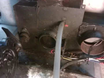

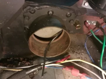

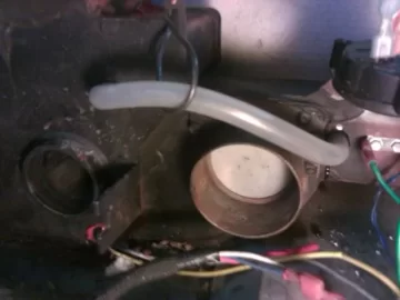

If you are getting creosote. or smoke in the hopper, try this mod. Worked for me.
  • [Hearth.com] Fire behind the burn pot of a Harman Accentra FS...
thats the mod I suggest the op search for n the beginning. I just let it burn. I can't see any harm as long as its not getting to the exhaust blower which it isn't. It contains itself around the burn pot. I do knock it down occasionally but I gave up on cleaning it
Hi tonyd,
Do you suggest this for creosote anywhere ?
I just had a long conversation with a harman tech and they said I should not have that done it will not help this problem .... they said it is only a modification for smoke in the hopper ...
not saying they are right just asking if it has worked in this situation ( flames outside the burn pot )

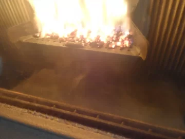

I would like to see pictures after the stove is turned off and cool. Don't do anything other than open the door and take 5 or 6 angles, then we can dissect and discuss before cleaning and taking more pictures.
In some of your burn pictures the flame guide appears lifted on the right front. Could be just the pictures. You said you also have 3 flame guides. can you post pics?
O.k. here are some pics...

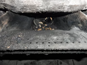

this 1 is cleaning warm pellets out after stove was turned down

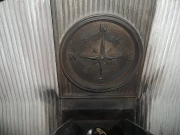

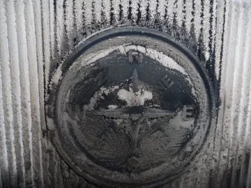

back plates and compass before cleaning

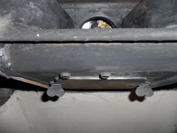

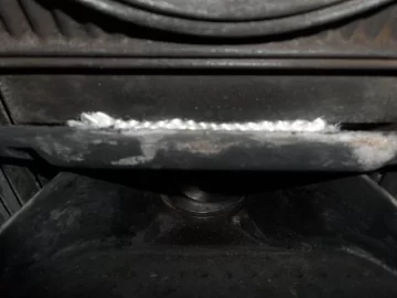

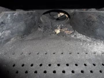

where flames come out the bottom ( what I call creosote the black shiny stuff )

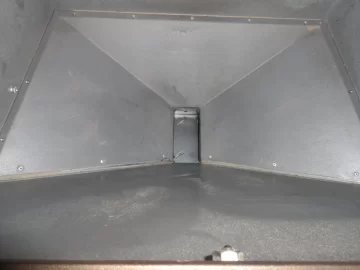

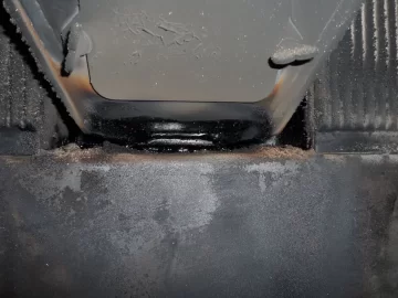

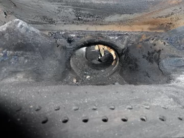

up close auger & burn pot with flame guide removed

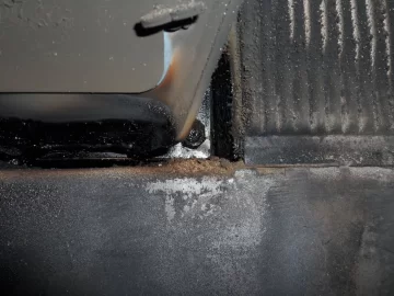

another pic of where flames come out the bottom
[Hearth.com] Fire behind the burn pot of a Harman Accentra FS... [Hearth.com] Fire behind the burn pot of a Harman Accentra FS...

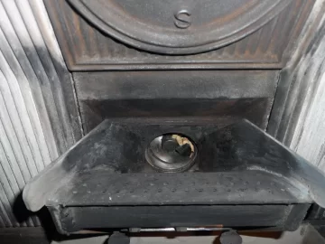

the following pics are of cleaned stove parts

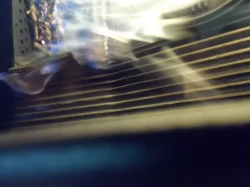

Anybody see anything that could be causing the flames outside the burn pot in this series of pics
In an unrelated item your feed rate is too high.
Thanks it is only set on 2 ...
good thing is when it stops initial feeding and ignition the pellets burn back and make an ash line that stays behind the 1' from the edge . So I do not turn it any lower or it burns back in the throat of the pot I tried 1 and 1 1/2 ...did not like the fire so far back... These pics were taken within minutes of igniting

That shiny stuff under the pot is very strange and doesn't look right. What the heck would cause that?
Gummy stove syndrome. It was a big issue years ago. There may still be some info in the archives, I don't know how long they keep them before they are purged.
Is the access cover on the burn pot leaking ?? If not it would seem to me the pot gasket is leaking ? Also is that pellet fines, dust under the pot ?? Just some thoughts.....
Yes they still have info on gummy stove syndrome. read many posts on gummy stove syndrome
which the cure for was the air kit with the clear tubing... ( the Harman tech does not think I have gummy stove syndrome though ... again not saying he is correct just relaying the diagnosis of it not being that )
Only question I have is this literally happens within 20 minutes of turning the stove on after cleaning it off... and it is only in the places where the fire outside the burn pot flames are...
Just had a new burn pot with access cover and gasket put in by Harman tech... that is ash that flies around from the fire and accumulates there... before we changed the burn pot actual pellets used to drop there and burn but since the new burn pot only flying ash accumulates there ... I've watched it very closely since replacing the burn pot to see what is happening... Thanks

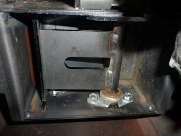

In reference to gummy stove, I'd be curious to see what your slide plate looks like.
Sorry I did not get a pic of the slide plate as that was taken apart by Harman Tech who said it was clean... and operating perfectly...I did see it and there was no build up of any kind on it. Just could not snap pics while he was working in there.
he also said auger looked fine...

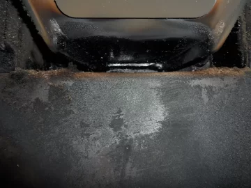

These pics I took when we were shutting the stove down to try a new fix ( no Harman tech here )... we also were not doing a good thorough cleaning as it had not been done that long before the experimenting ...
Tech said that the new burn pot made a tight fit/seal... watching him I did not notice any warping on the back wall ... but I was not doing the job myself...

Is that rust or pellet fines on the picture in the right? I bumped into one of your earlier post where you mentioned you found foam in the pellet. Was this observed prior to noticing the flames underneath the burn pot? I admit that I fishing for a cause, but really you should check the wall as suggested earlier.
Pellet fines...

Actually have Harman tech coming again on Monday to install that air thing with the clear hose that the newer Accentra's come with now... I have been playing with some other fixes and will update after I see the results after a little longer time... and after the tech comes and installs the air modification. The one that 3650 and others have posted about.
