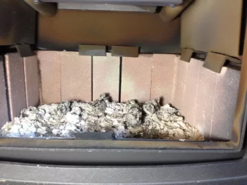

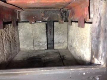

They say a picture is worth a thousand words.
Alderlea t5 insert.
[Hearth.com] Fire brick questions
Blaze King Ashford 30.
Firebrick protects the stove body and holds the heat in the coal bed which helps the fire burn hotter for more complete combustion.
