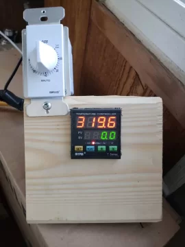

I added a K type thermal probe to measure the plenum temperature and it is WAY off. I am measuring 110 F when the HLC reads 150F. Just didn’t know if there was some way to get better controls for the system while I wait for another unit to be delivered.
I'd just adjust the Honeywell to compensate if you want something higher...not worth fooling with for a short term problem...IMO

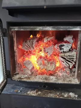

Little over 3 hours into the burn. Loaded to top... only with 16-18 inch splits.

No smoke shield?
Doesn't come with one... and never really had the need for it. Once the first layer of wood is laid down iv never had smoke come back into the house.
Even after tossing one log on the fire I rarely have a trickle of smoke roll out.

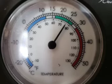

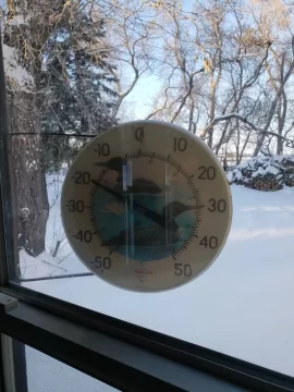

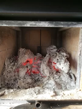

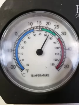

About 7.5 hours. So far house is still at 74f. I expect to get about 1.5 to 2 hours until I need to reload at 69-70f.
It is currently -4f outside.

That's called "boost air"...it has a 1/4" hole that blows a little air right on the base of the fire to keep things rollin after a reload, mainly once the main intake damper closes...basically, it just helps keep the primary fire going a bit. Many "tube type" stoves have a version of this.
There is one in the back too...you can see it in @Case1030 's "7.5 hour" pic...about halfway up, right in the center
