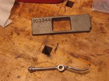

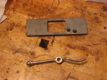

Here are a couple of pics of the replacement parts,that supposedly do not exist, I received from my dealer.
The part # for the lever is 128363 and 103344 for the plate.
I will probably replace the parts next week and will post results and comparisons in a new thread.
J.P.
Edit: These are for the 500, however from what I can tell both the 500 and the 600 have the same issue.

Nice, SmokinJoe. If you get a chance, when you get the new parts, can you take some close up, side-by-side comparison shots of the old part next to the new? It would also be helpful to get a shot of the binding point in the stove and where they corrected the problem with a change in the new lever.
It will be interesting to see why Jotul made a replacement part rather than a tech bulletin with a small field modification.

the replacement lever is still in the "testing stage" i have put about 5 or 6 it fixed all but one it seems to bind when hot and fine when cold the lever has a diffrent bend which takes some of the tension of the slide plate.

Hey Stoveguy, did the Jotul rep tell you the levers were still in testing? My dealer said the plates were re-designed and he had no word on the levers until I let him know what I found on this site.
