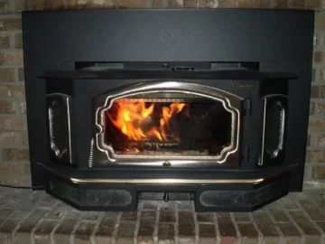

We went with a Lopi Freedom Bay insert in our fire place. Our local dealers where I live had the BUCK, and LOPI brand inserts. My brother got the Buck 80 insert installed in his fire place & I got the Lopi. Both inserts are doing fine. My brother is very happy with his purchase and I am as well with our Lopi. There are a lot of inserts out there and most are very fine, and I'm sure you will get many replies about brand X is the best.

Anyway... here's a pic of our Lopi.

atvdave, That's a nice looking Bay. What ship were you on? I did 3 years on the Independence (cv-62) out of Yokosuka, Japan.

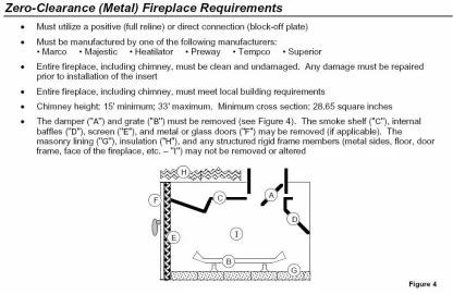

Aces67, Below is a screen capture of the Lopi Revere manual. It says it's approved for use in a Marco. There are lots of people who disagree with doing anything to a zero clearance fireplace. They're kinda the red headed step-child here. There aren't many stoves that are approved for ZC fireplaces so you'll be limited. My advice is to not just trust one stove shop because sometimes you'll get people who don't know what they are talking about come out and try to rig you an install and charge you double. You're going to have to do some homework but it'll be worth it because then you'll have peace of mind after it's all done. If you're anywhere near handy then I'd suggest you do it yourself if it's allowed by your insurance and city.

I understand some of the newer factory/pre-fab fireplaces have a UL specification that meet the requirements of some Insert brands.
