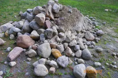

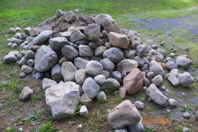

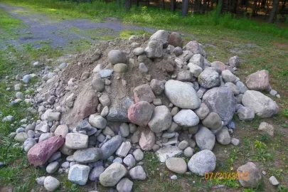

    Decided that it was cheaper having Ward deliver some rocks from their pit in the 6 ton Ford (truck to the far left on the top) looks like tomorrow will be spent clearing some skinny trees in the area the fireplace is going.
    The fireplace looks like it will be done before the end of August. (target date)
    Zap ::-)

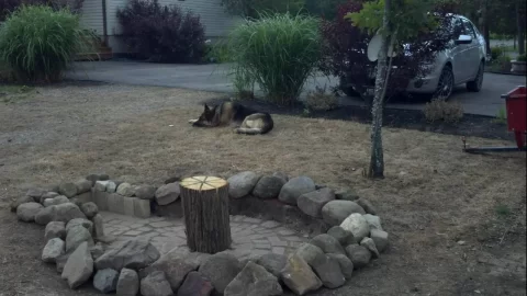

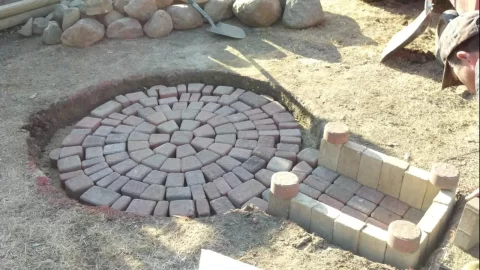

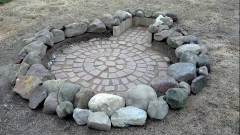

    I had a thread awhile ago. But here ya go.... (click to enlarge)

    Very nice Dex. I think we will go smaller than yours but with higher sides. I think we will go with a rounded (not sure how round) fireplace with the keyhole design.
    How far did you dig down? I think from talking with Hearth.com Members, 12 inches deep sounds right.

    I went about 12, then laid down 2"-3" of sand, then added the pavers. So its only around 6" deep, then add the height of the rocks and its over a foot deep again...
    I should have went smaller also. But I was lookin at the painted circle I laid out and decided to go BIG or go HOME! ;)
    Well, it was to big :) Its 5' in diameter with a 24" x 24" cooking area (complete with firebrick on the sides) but subtract the brick and its about 20" x 20".. Overall Im still happy.
    Its obviously not as pretty now. Those pics are from the day I made it....

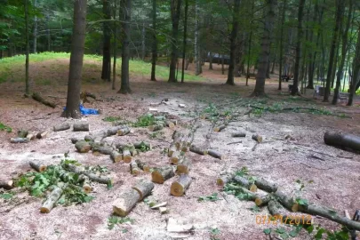

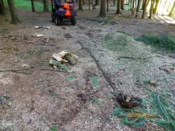

    This was the work done today in the area of the soon to be fireplace, we had one tall thin Cherry and about four small maples that were cleared. Tomorrow will be spent splitting then cleaning the area up.
    zap

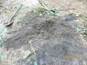

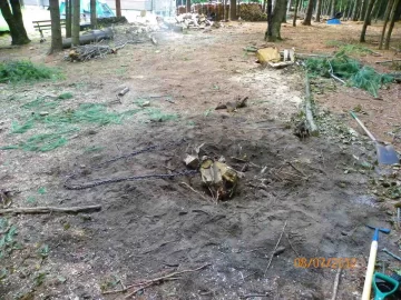

    Started the stump removal tonight, the little maple stump was a pain in the ass, it took a good hour with the grub hoe. I finally cut enough of the roots so the Rhino could rip it out, another stump left then it's time to dig out where we want the fireplace. Once I get the second stump out I'll give my neighbor (Nola) with the tractor a call so she can move the big rocks back to the area the fireplace will go.
    zap

    I dug down about a foot, then added a few inches of sand and then pavers and placed the large rocks on the level ground above. So its still over a ft deep (from top of exterior rock to paver).

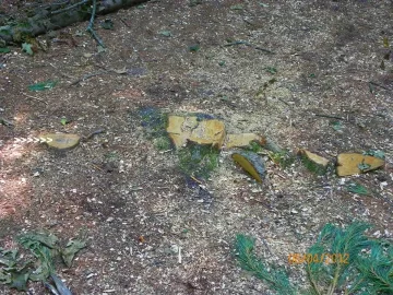

    We removed the second stump last night (had two helpers, 5 & 8) we made sure that most of the roots were cut before we pulled it out with the Rhino. So the pay they received for the work they did was some camping last night just behind the house in the tent.
    zap
