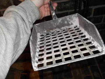

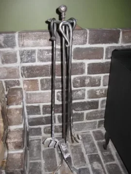

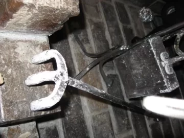

I made all my tools so cost was not prohibitive. Never use the poker since I fabbed up the rake and use the shovel to clean out. Picked up a cheap hand broom/brush and dust pan at the dollar store and a $20 baby shop vac at wally world for around the hearth. Made a sweet coal sifter and would give it away if it wasn't so big to ship. Just find it a waste of time for me.

  • [Hearth.com] Fireplace tools: I assume I will need a set. But what's really essential?
