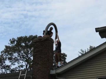

    The installer had great communication and did a good job.
    He removed the damper and inserted the heavy duty smooth liner that I paid extra for.
    He installed this fitting and had to cut a small portion out for the rod that opens the top damper air bypass.

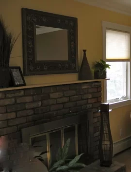

    This was the before by the way. I did all the work myself.

    My thoughts on install.
    Man we payed a lot for this thing, I hope it works and pays for itself eventually!
    Installer was really nice, but this was a really easy install. Ranch home. Virtually straight flue. I probably could have done it myself.
    I don't think he installed flue cement at the connection between the liner and insert. I think I would be able to see it?
    His normal protocol is to just insulate at the top of the chimney. I had to ask him to add insulation at the bottom of the liner where the old damper was. He chuckled when I asked and wondered why. I tried to explain the best I could and told him it was because of my research that I did online. I mean cmon, what did it take about $4.00 in material and 4 minutes of time?
    My wife loves the look and I think we will do well reducing our oil bills. I wish I got a free standing stove, but this option worked best for us.
