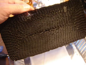

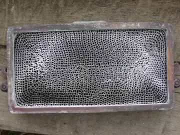

I did the cat wash yesterday.
First I took the cat housing out of the stove after I let the fire burn down to just a few coals. Before, top and bottom.
[Hearth.com] Fireview Cat Wash [Hearth.com] Fireview Cat Wash

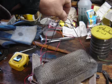

Took it out the barn and opened up the housing. The Gasket will crumble as soon as you pull the cat out of the housing. Don't even think about doing this until you have a replacement handy.
I put some light gauge wire through the cat to get it in and out of the water.

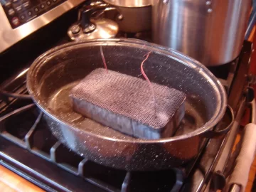

The hard part was finding a pot big enough to keep the cat submerged. The cat is about 4 1/2" X 9 1/2" X just over 2" thick. I found something, but I'll have to replace it by Thanksgiving.

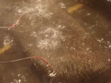

The even harder part was getting 2 gallons of water and vinegar to a boil...and it did stink up the house a bit too. When it first went into mixture there was quite a bit of bubbling. It really looked like stuff was going on in there.[Hearth.com] Fireview Cat Wash
